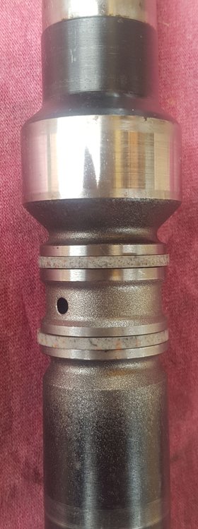

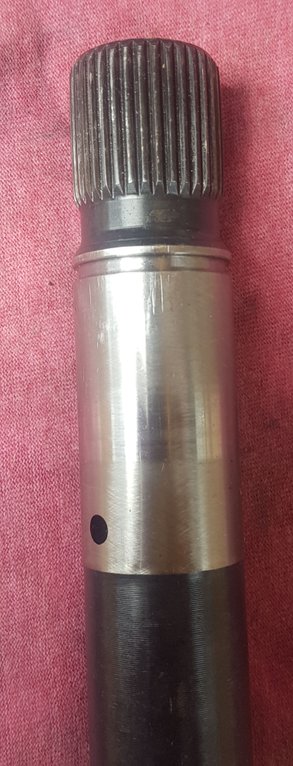

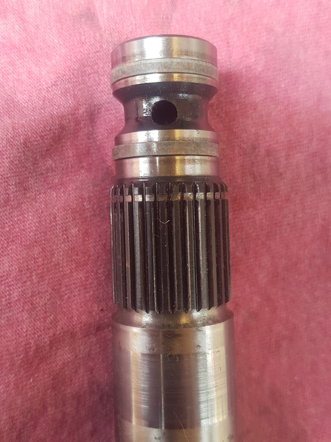

So I pulled the transmission and started the disassembly. The friction packs are 0.07" in one of the pack, and 0.08" thick in some other pack, I cant remember which is which, I just tried to get some measurements to see if the friction plates are in spec. The metals look good to me.

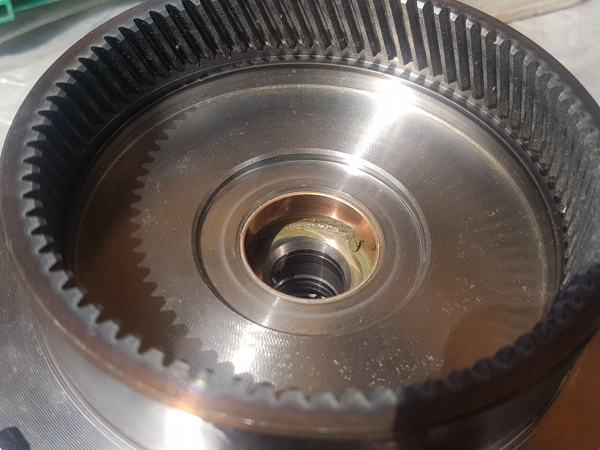

The bushings look not bad, the only one that is pitted is on the pump assembly. Do not see any obvious signs of a catastrophe.
I tested the solenoids for Ohm values, they appear to be in spec. The plate between the valve body and the transmission housing has some check ball "damage".

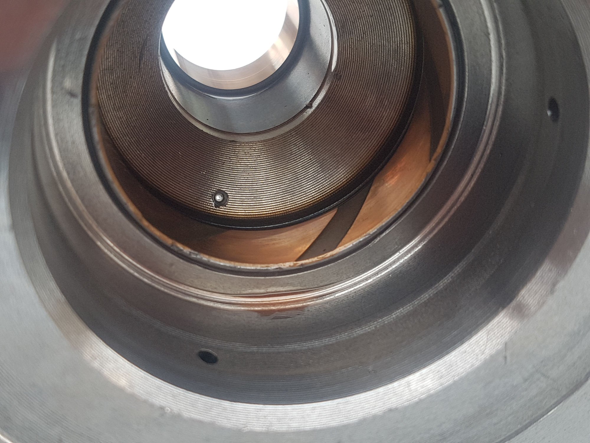

Haven't checked the harness for conductivity yet. Do not see any reason to disassemble the clutch packs with pistons in them. The transmission had some black "sooth" internally but nothing overly thick or muddy.
So I do not know what is the recommended kit to get or what parts should I replace or service. I guess the separator plate with is a must. Do the bushings look ok?
What else can I troubleshoot for the problem I am experiencing?
