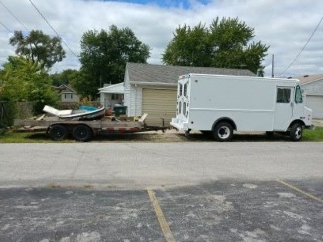

Well have a p-30 Grumman Olson. Its a 1998 year 5.7 vortex. Don't power up the warning lights but radio and all lights, starter works. No fuel pump power. Did they use a power up relay. All fuses are good.
Also fuse able links feel intact. Cant get scanner codes as not powering up. any thoughts.
