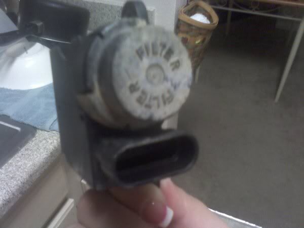

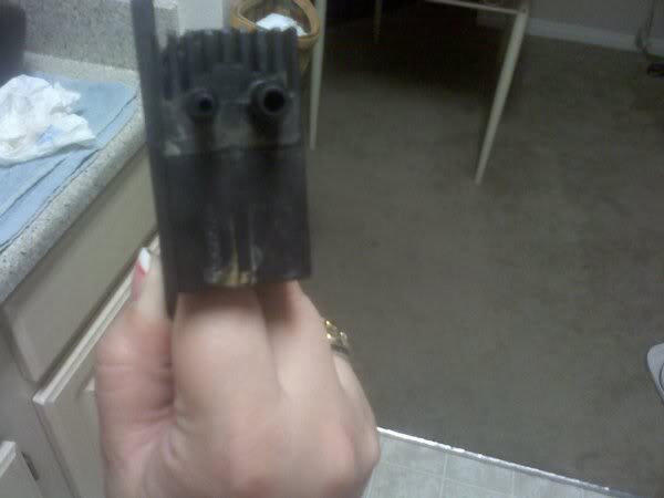

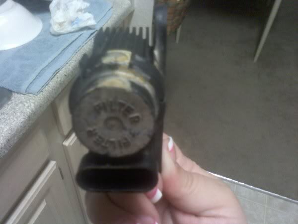

So for 2 days i have been chasing down a problem with the Jimmy's idle surging and dying. After checking and replacing just about every vacuum line. I found that the EGR was not getting enough vacuum. I tracked it down to this little thing.
What in the world is it? It connects between the EGR and the vacuum port on the TBI.
I disconnected the EGR from it and manually gave it vacuum and the Jimmy idle perfectly. I reconnected it to where it belongs and it just died.
My question is.... What is it? Can it be bypassed?
Any help would be appreciated.
Old Jun 17, 2010 | 9:39 AM
maxxman04's Avatar
Joined: Dec 2009
Posts: 1,851
Likes: 3
From: kentucky
egr vacuum solenoid.
http://shop.advanceautoparts.com/web...S_784426334___
Old Jun 17, 2010 | 6:43 PM
MDTAHOE's Avatar
Professional Mechanic
Joined: Nov 2008
Posts: 2,950
Likes: 5
From: Bowie, MD
It prevents EGR from getting vac when it should not. EGR should not be open at idle, thus no vac at idle.
