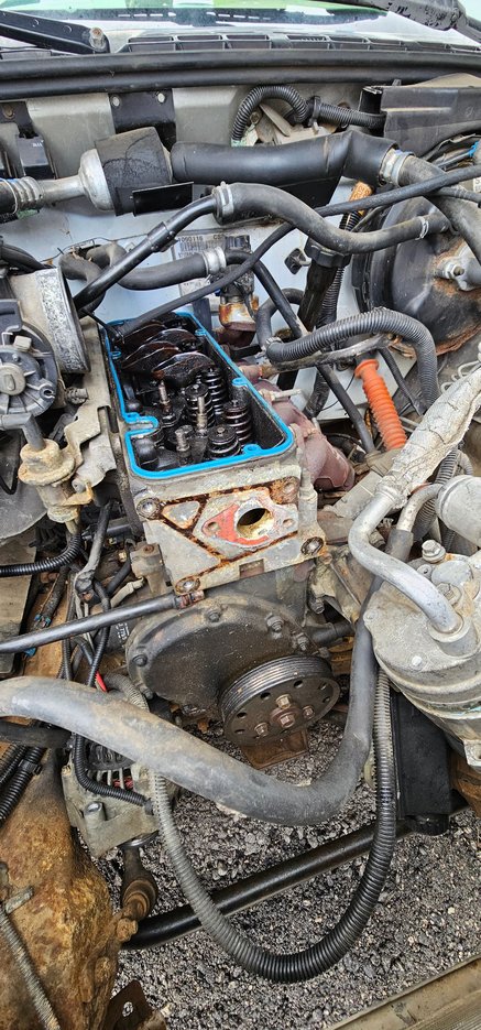

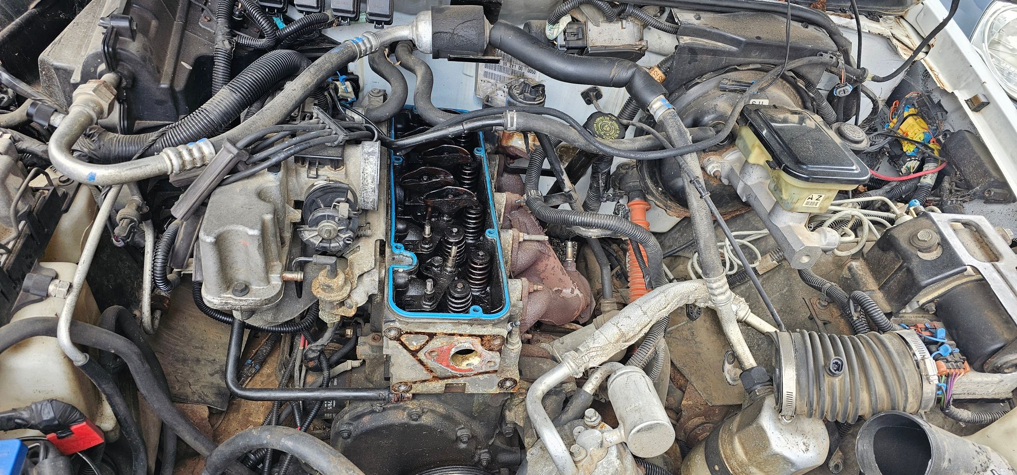

We have S-10 that requires some engine maintenance, but I am having difficulties to identify the exact parts needed, since VIN number check on multiple sites shows different results (some say engine is 2.2L, other 4.3L).
VIN number is 1GCCS1448VK174579.
Any help would be really appreciated
Some pictures are attached

Welcome from Florida. The picture you have shows that it is the 2.2L. You can us the vin decoder found on this site in the tool tab which shows that it is a 4 cyl.
