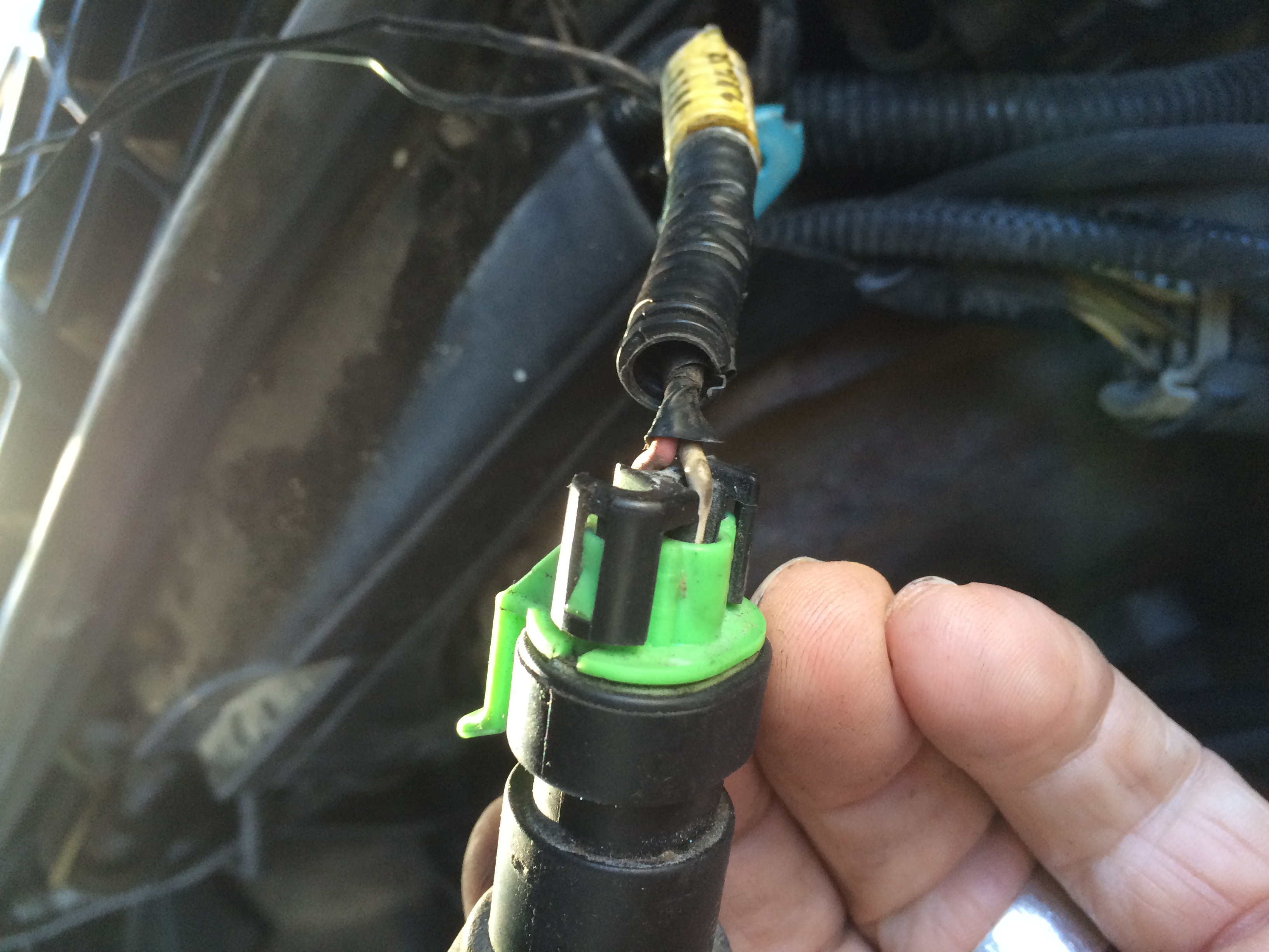

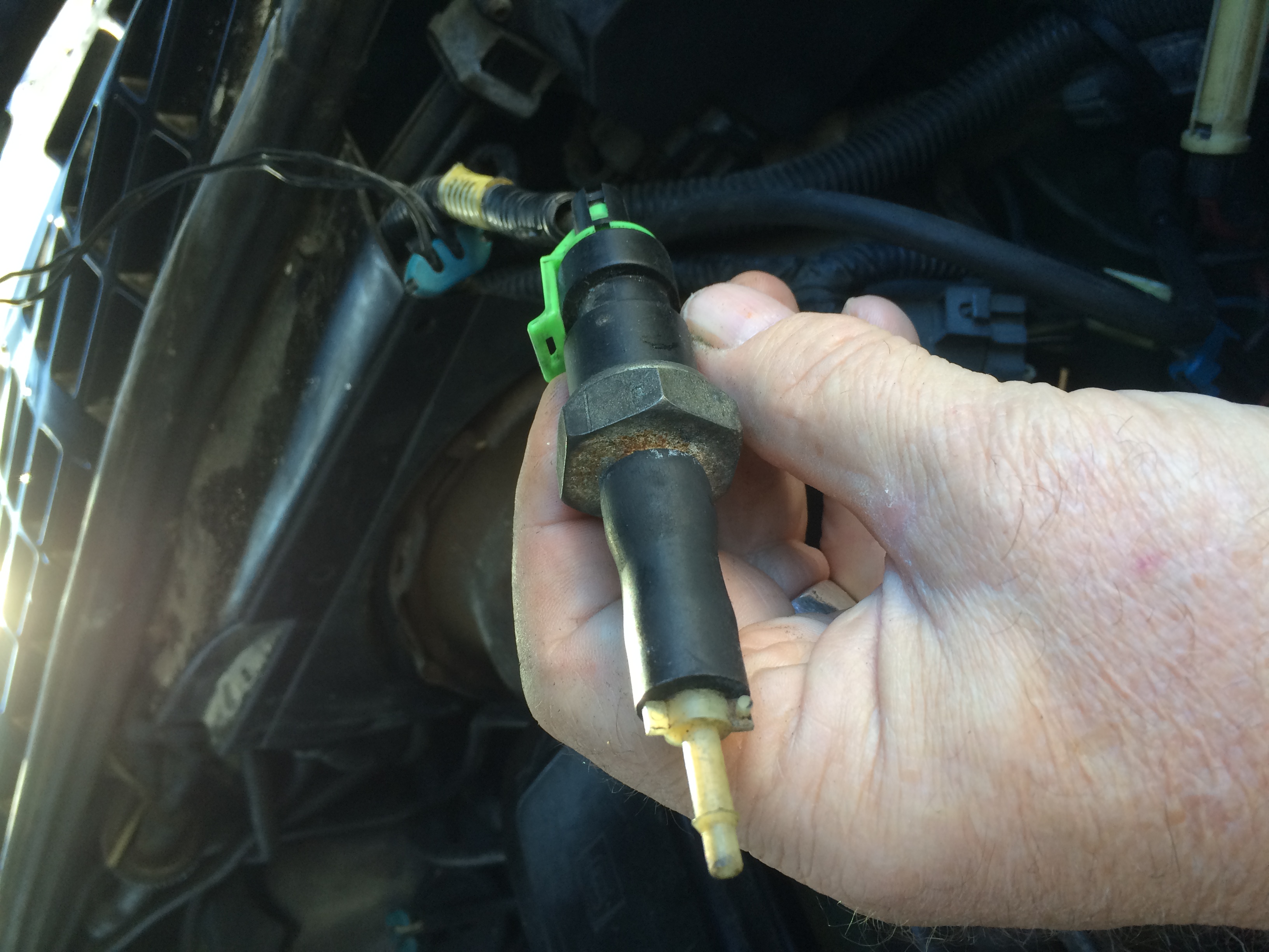

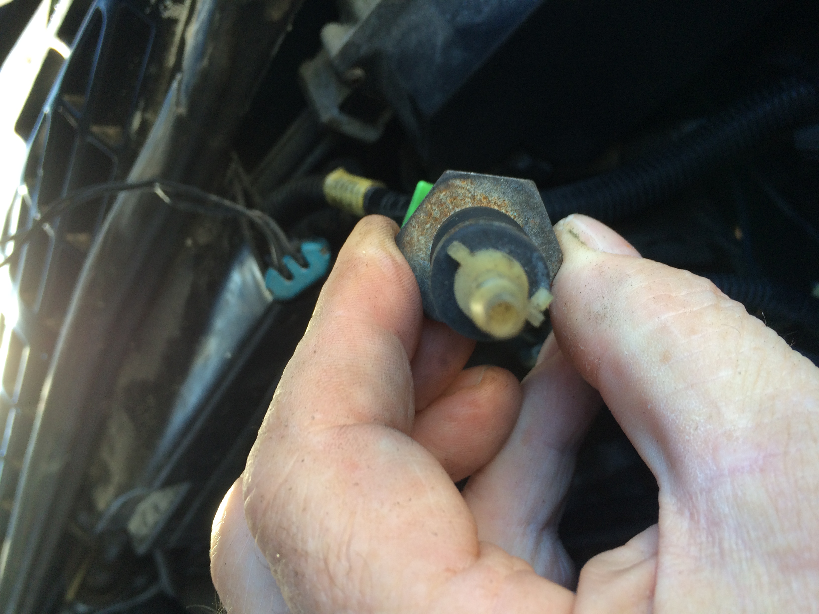

I recently bought a 1995 S10 LS 4wd and I need some help identifying a part. The vacuum system seems to be disconnected. It runs good but I have unplugged lines including this one. Can anybody help me solve where it goes. What is it and where does it go?-img_0850.jpg

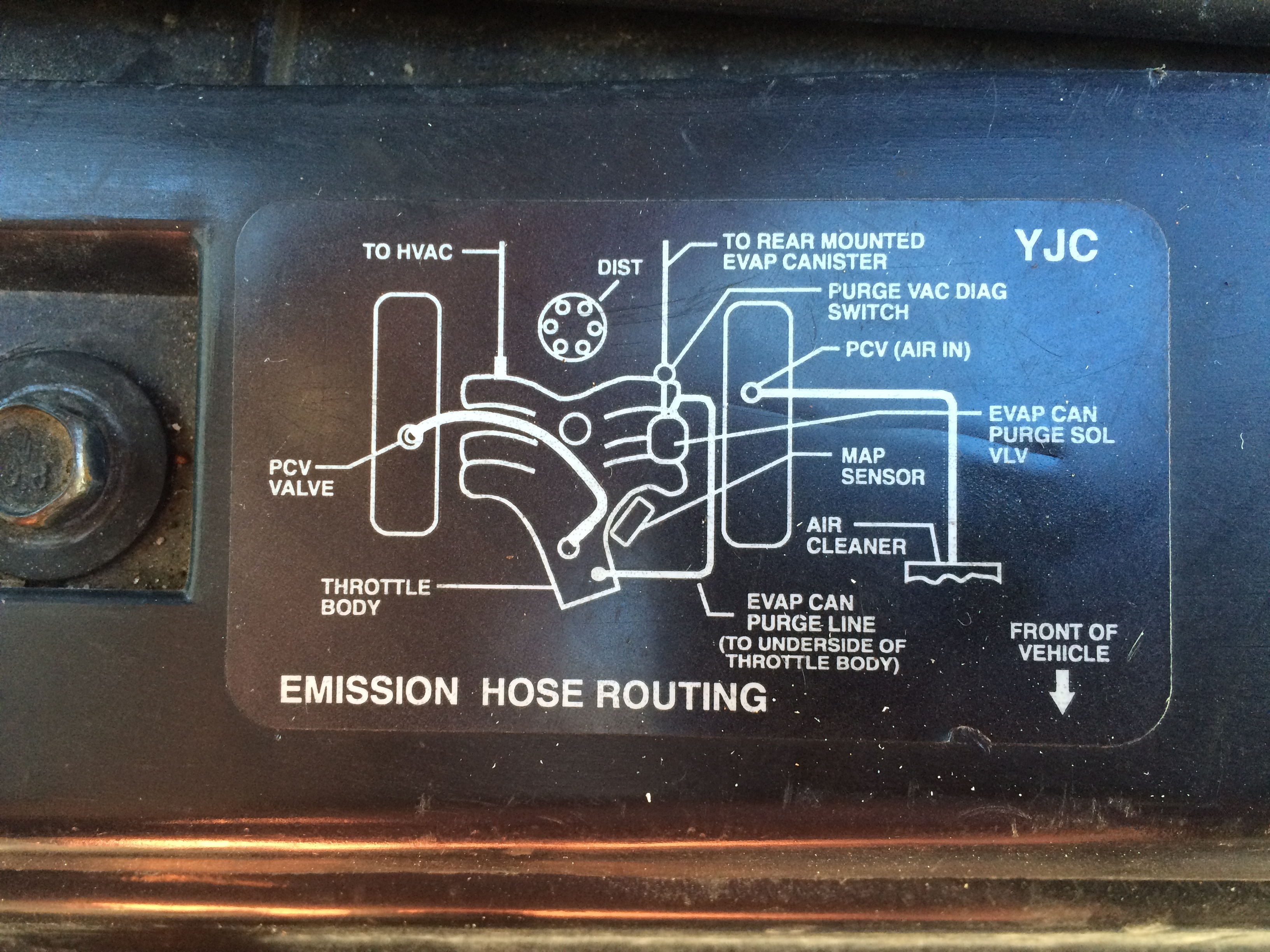

what engine? 4.3 with intake runner control valve??
is there a vacuum hose routing diagram in the emissions label under the hood?

The motor is a 4.3 and I have attached a picture of the diagram. Anything that you see would be a big help. Thanks

not sure from the 1st picture....what are the 2 wire colours?

White and either a dull rust color or a faded rose color. Its hard to tell with the age and grime.
Old Jan 19, 2016 | 7:47 PM
the evap canister purge vacuum switch is located on the top left side of the engine and has one white wire and one black/white wire.
