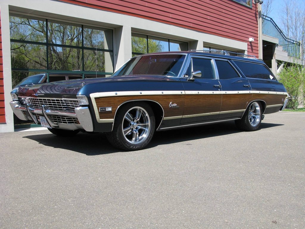

Hello Everyone,
Found the site, and thought I would share some pics of our '68 Caprice Wagon. I love sharing pics!

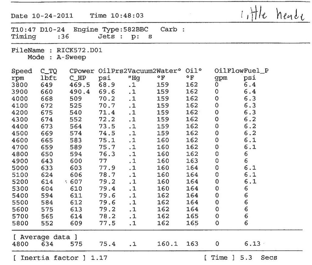

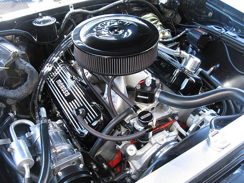

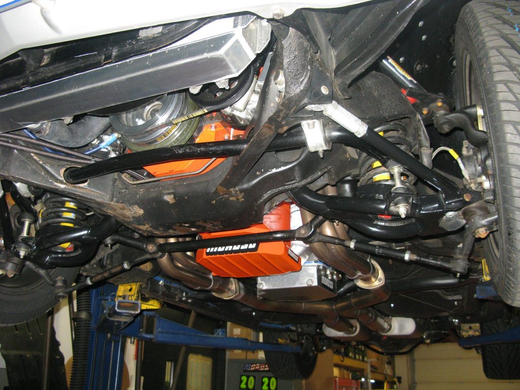

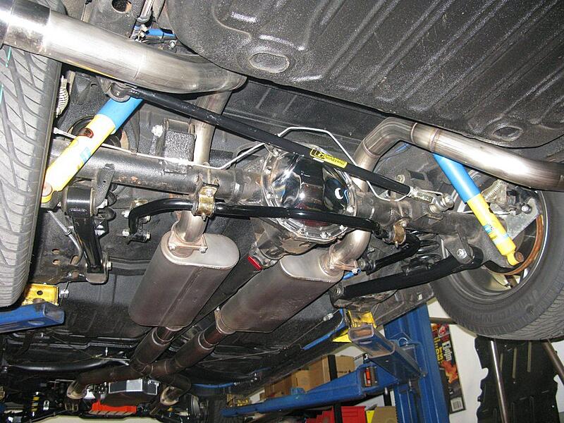

It has a 572 BBC. Made 614 hp, and 675 lb/ft. Tubular control arms, custom springs, big anti-roll bars, custom shocks, dropped spindles, 13:1 steering box, 4 wheel disc, turbo 400, 3" stainless exhaust, ect...
13 inch rotors, w/6-piston front calipers, a rack and pinion, and a 5-speed stick are all on order and will be in the car within the month. I can't wait!
Hope you like! See you around the site!

Sweeeeeet! Nice ride!!! Did you do a restoration...body off? Awfully clean undercarriage!

Thanks!
No body off. I bought the car with the paint and decals done. I did the rest of the car. We just scraped the bottom, and sprayed it with truck bed liner.
