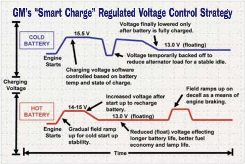

Voltage sounds normal to me. you don't need >14V if the battery is already full because that'll overcharge it and kill it over time.
do you ever have trouble starting? If yes, then have your battery load tested. Make sure all your connections are clean and tight.
https://docplayer.net/47372792-Are-y...n-a-smart.html
