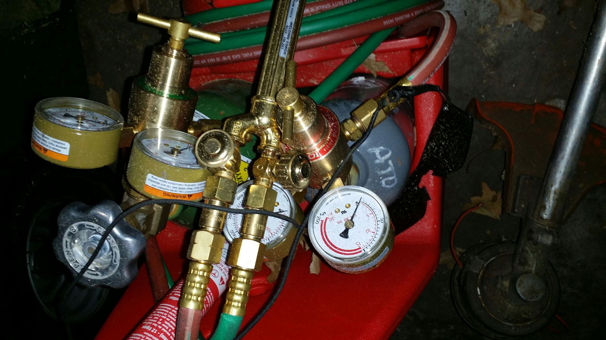

I bought my son this when he replaced his upper control arms, I call it a gas hatchet, or blue nosed wrench.
