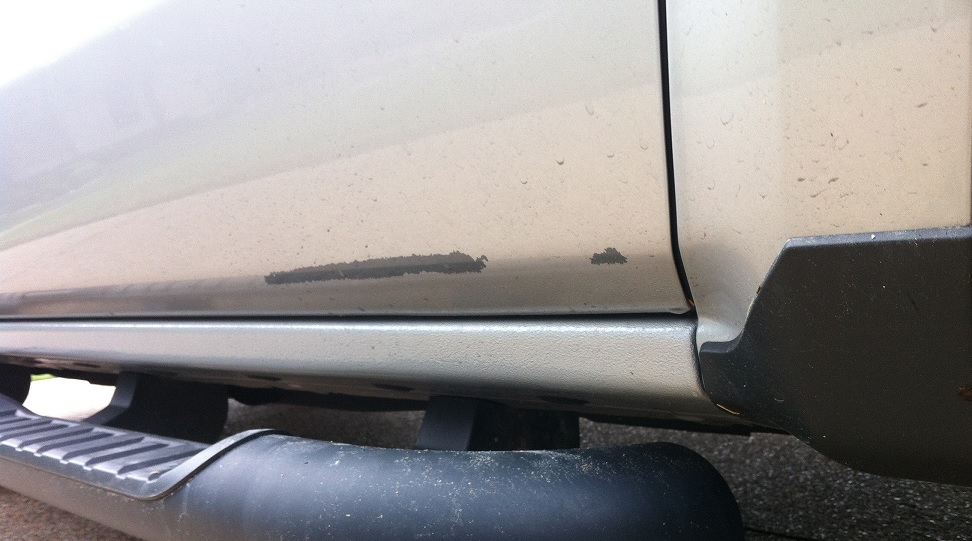

Be sure to keep a close eye on the bottoms of your doors and fenders which have chip guard!!
This also applies to the 2014 GMC Sierra - so if you know anyone who has one - advise them as well.
Chevrolet/GM are keeping this quiet to limit repairing a lot of trucks. It is difficult to notice and even the Rep had a hard time finding it (when he knew about my warranty claim and supposedly has researched the history - aka, there's a picture in the Service Bulletin).
Our 2014 Silverado was roughly 16 months old with 10,000 miles when we first noticed a chunk of paint missing from the bottom of the passenger door (roughly the size of a nickel or dime). At first I thought something had hit it to chip the paint off but close inspection showed all the primer was perfectly intact and there was no door ding or dent in the area.
We have side steps which help protect from rocks and there is the “anti-chip” paint treatment just below it this area (isn’t that odd, the paint chips away from the “anti-chip” area). After observing things for awhile, the area was getting larger and larger and about the only thing I can think of is just normal car washes and drying it off is causing more little chips of paint to fall off. This vehicle doesn’t go off-road or travel any dirt/gravel roads.
I did some research and found out about PIT5313A (although the latest version is now PIT5313C). So I go to the dealership where we purchased the truck and to the body shop manager. He comes out, takes a look at it and states that he’s seen a few trucks with the same issue and they repainted roughly the bottom 1/3 of the door. I asked if it was always the passenger front door and he said no and went on to mention that he did one truck and the guy was back about 3-4 months later with the same issue on a door on the other side.
I continue walking him down this road. Do you know what was causing this problem on his truck? Nope, just repaint the lower portion of the door and sent him on his way. Do you have any theory on why the primer is perfect but the paint is chipping away? Nope, maybe it is just getting sprayed too thin (which, as a side note, I’d agree with because the thickness of the paint/clearcoat is really thin). I express my concerns that just painting the lower portion of my door doesn’t mean I won’t be coming back several more times as other doors start peeling. I didn’t spend ~$42k for a truck that needs it’s panels repainted on a regular basis and what am I supposed to do when I get beyond the standard 3yr/36k warranty? Heck, I’m having too many problems getting this door fixed and it is within warranty!
I fill him in on PIT5313, he looks it up and says that they are supposed to run 2” masking tape just above the “anti-chip” area and then pull it off quickly to see if the paint pulls off any of the other panels. Did he do that with the other truck which was in twice for repainting? Nope. He goes out to do this test on our truck and the other three doors don’t peel any paint. He and I agree about not being sure of the validity of this test without cleaning the area of all the stuff which may affect the masking tape from sticking (wax, grease, dirt, silicon, etc). He says they will degrease those areas and retest when the vehicle comes in to get the warranty work done. He agrees that PIT5313 calls for a full repaint of the door which would require blending into the fender/rear door. He says GM doesn’t specify that and isn’t compensating him to do that. With him knowing we plan on keeping the truck 8-10yrs, he’s concerned about his shops “Lifetime ownership warranty” on all their paint/body work. Since he doesn’t know the root cause, how far do they have to strip it down to ensure a quality repaint (all the way to the metal?).
I explain that my concern is with the adhesion between the base coat and primer and that I’m concerned it isn’t limited to the just the small area above the “anti-chip” treatment (since I’ve seen how easily the rest of the vehicle gets rock chips compared to our previous Silverado). I also stated that since they require a full door repaint – this too indicates agreement that the paint integrity of the entire door is in question. I’ve seen no explanation to the official underlying cause and why/how the paint to primer adhesion issue is related to the “anti-chip” area and not the rest of the vehicle? My suspicion is that with time, a rock chip or a deep scratch and the paint will start peeling on any panel of the truck. He says there is nothing he can do/suggest and that I should have to call Chevrolet.
