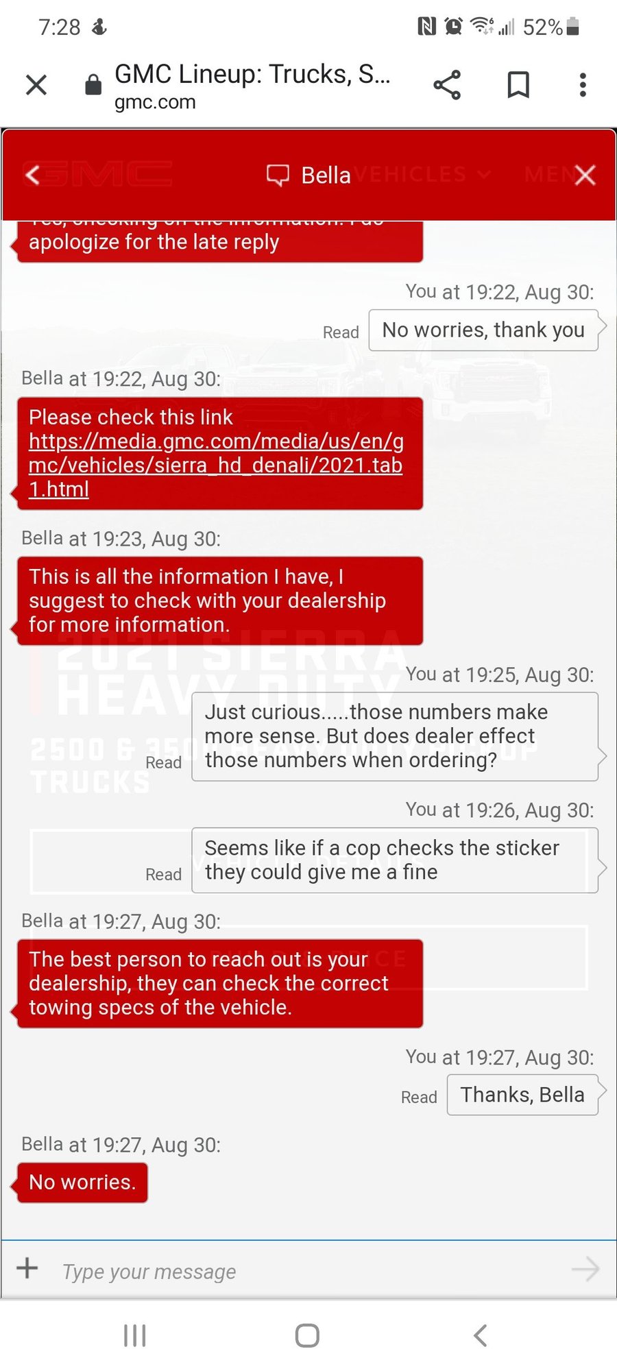

Old Aug 30, 2021 | 7:35 PM
  #12
Zc86's Avatar
Joined: Aug 2021

I used the vin decoder also and it says my dead weight hitch is 5,000 LBS for max trailer wt and 500 lbs for max tongue wt. Which is the pin weight as my sticker in the door says 2,775 lbs for a goose neck tongue weight and conventional trailer is 1,850 lbs.
Does anyone know where you can really figure out the gooseneck or 5th wheel pin weight capacity? I have a 2021 2500 HD LTZ. (model code CK20743)
