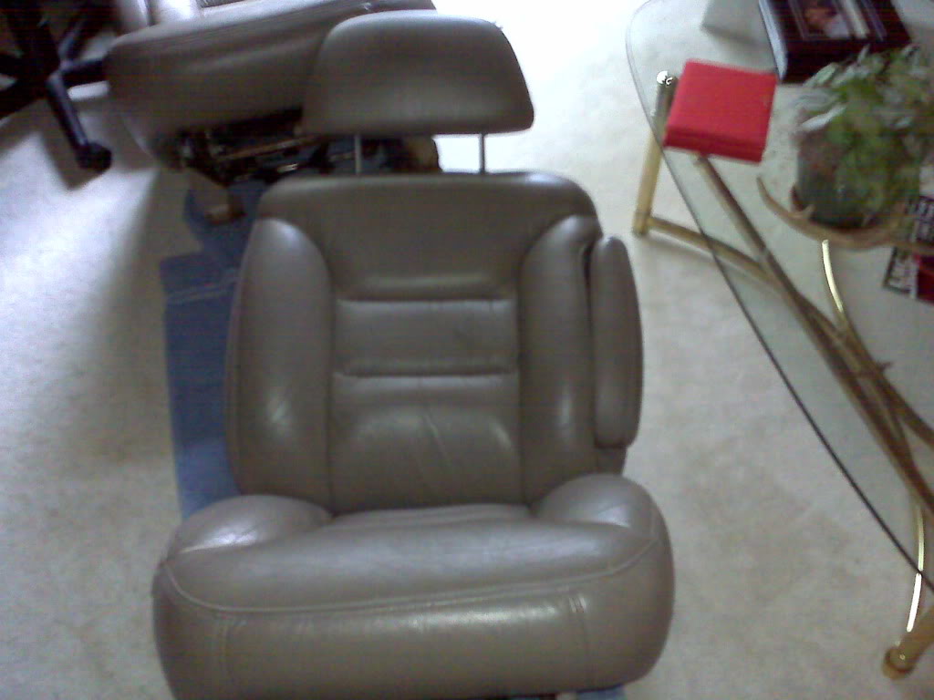

In case you were curious these are the seats I got for free....

If the passenger seat bolts up through the second set of holes, are the racks on the bottom of both seats the same? If they are, you should try marking and drilling in the same location on the driver side floor. I used large fender washers as well, to support the body, and keep the floor from getting distorted.
BTW, nice seats!
