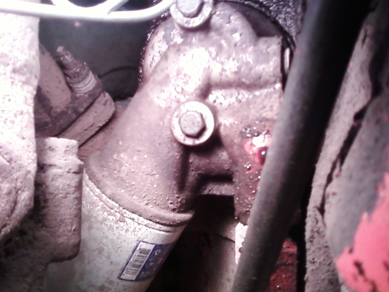

these are the before and after shots of my cooler line eliminator, the adapter is from unknown origins and the filter is a wix 57099, the best thing is that it doesnt leak and i gained about 10psi on oil pressure

Interesting. Did you just cap off the input and output?

i took the right angle adapter completely off and put an old style one above the filter

You can get the adapter from the dealer it comes off one of the GM cars that do not use a oil cooler. I have done it on a couple trucks I just can not remember what car we ordered it for

i found this one in the junkyard
