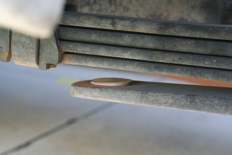

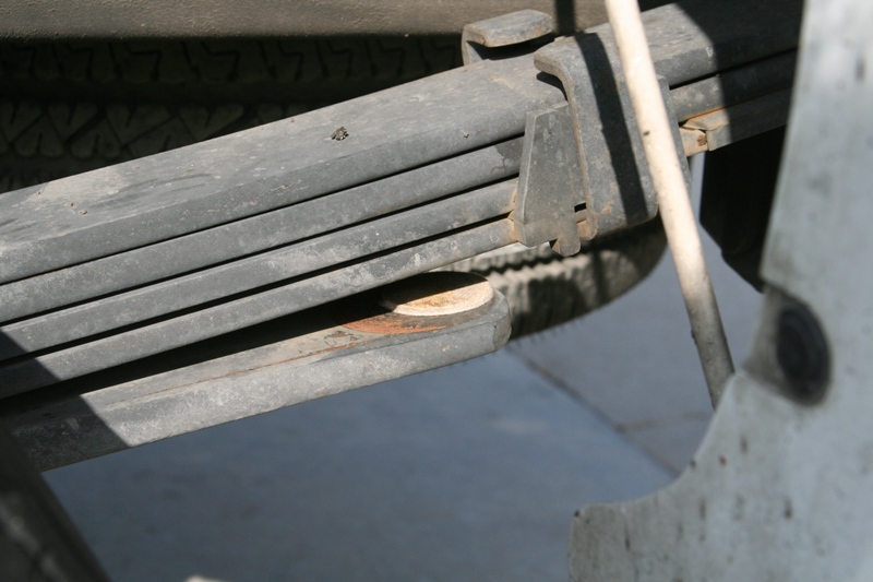

Originally Posted by rivereye
They do have shackles and pads for springs to restrain movement(Bad idea?) and absorb the "slap" sound. !!
I will try the 1/4 inch thick felt stickys, should be a $3 fix from Office Depot It will at least get rid of that metal to metal sound.
Old Sep 22, 2009 | 12:37 PM
  #23
Mike Sigmond's Avatar
ROTM Coordinator
Joined: Apr 2009
Posts: 1,828
From: Orange County, CA
Default Update on fix
Its been a few months now and these stickys are working great...
Not a clunk/slap since I put them on and they have been thru weather & water, still sticking. Not bad for less than $1 to solve it.
Attached Thumbnails Clunking noise in rear suspension-img_2425.jpg   Clunking noise in rear suspension-img_2424.jpg
