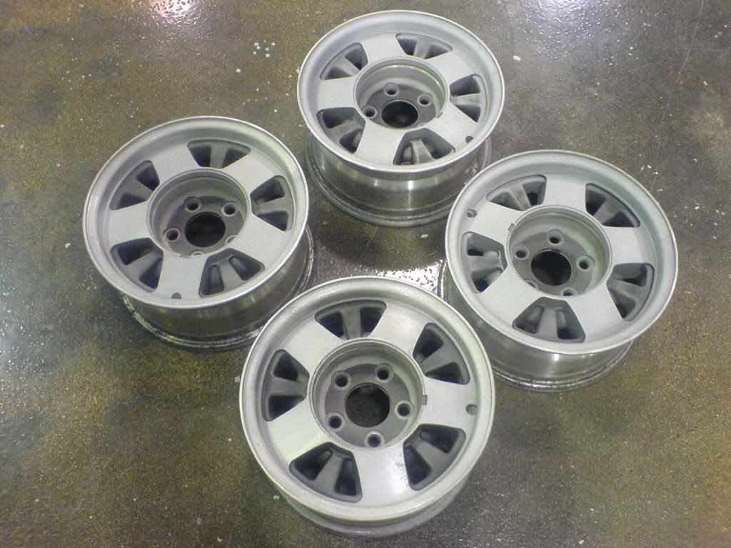

alrighty. got me some progress on the old rims deal. and evans... yeah ill get some pics of the resto as well... hope these pics work...
after blasting
http://i651.photobucket.com/albums/u...9/DSC00598.jpg
aftercurb rash is grinded out and smoothed
http://i651.photobucket.com/albums/u...9/DSC00600.jpg
in the paint booth doin a little bakin'. 152 degrees is kinda warm...
http://i651.photobucket.com/albums/u...9/DSC00601.jpg
after some sanding and then letting it cook more
http://i651.photobucket.com/albums/u...9/DSC00602.jpg
on the last pic i know the edge looks not so clean but thats cuz of teh light hitting the primer... for some reason this primer takes 3-4 hours to dry... hope you like my progress. as for materials...
2 bags of black blasting sand, auto prep, 400 grit paper, scotch brite, 1000 grit paper, self etching primer(2 cans) satin black color(2 cans) clear(2 cans)(rustoleum) and of course rims.

Why did you have to bake the primer?
Just curious. But most self-etching primers don't need curing out. I primed my rims with it and had them fully painted and clearcoated within a 4-5 hour period.

well i didnt mean bake... i was bored and impatient so i cranked the spray booth temp up. figured id shave off an hour or two letting them sit in a room at 153 for 20 minutes. i figured id put 3 coats of primer on. three light coats and then sand and color and color sand and clear and wet sand.

I used a bonding coat and a covering coat. Then I used 3 coats of ceramic paint and used a wheel coating for clear coat.
I can't beleive its already been a year since I did it.

i cant really tell the color of your truck. mines the dark metallic green. and where did you get that cowl hood? im doing that this summer and im still looking around for some good steel hoods. and evans, i was going to use some ceramic paint but on the can i read that for it to really cure it needs to be baked on. and so thats why i didnt use it and went with wheel paint. but now we both see it would have worked. did you sand between primer and color then sand between color and clear?
