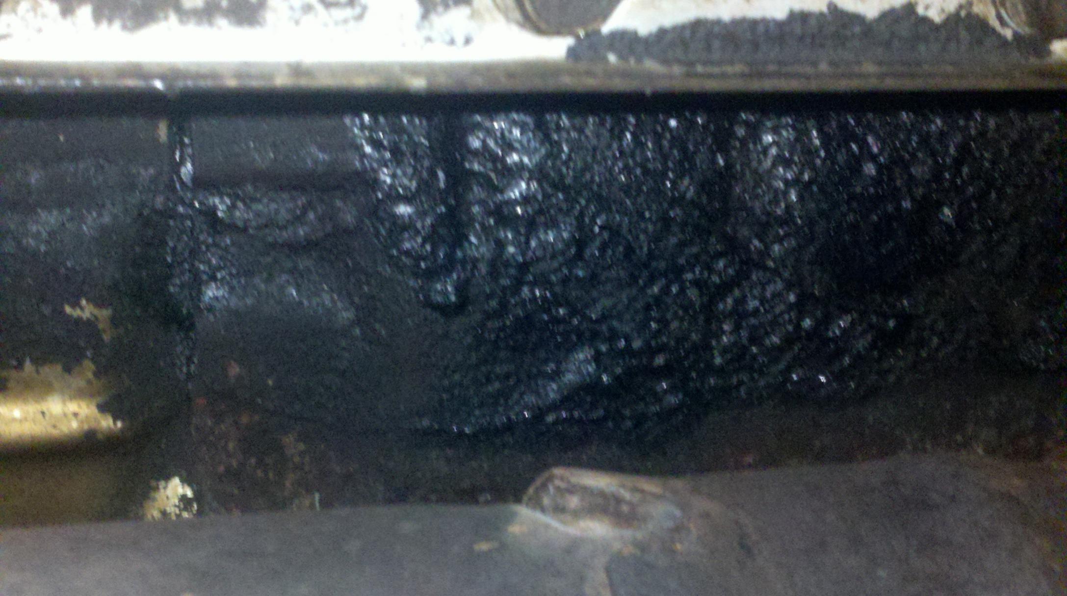

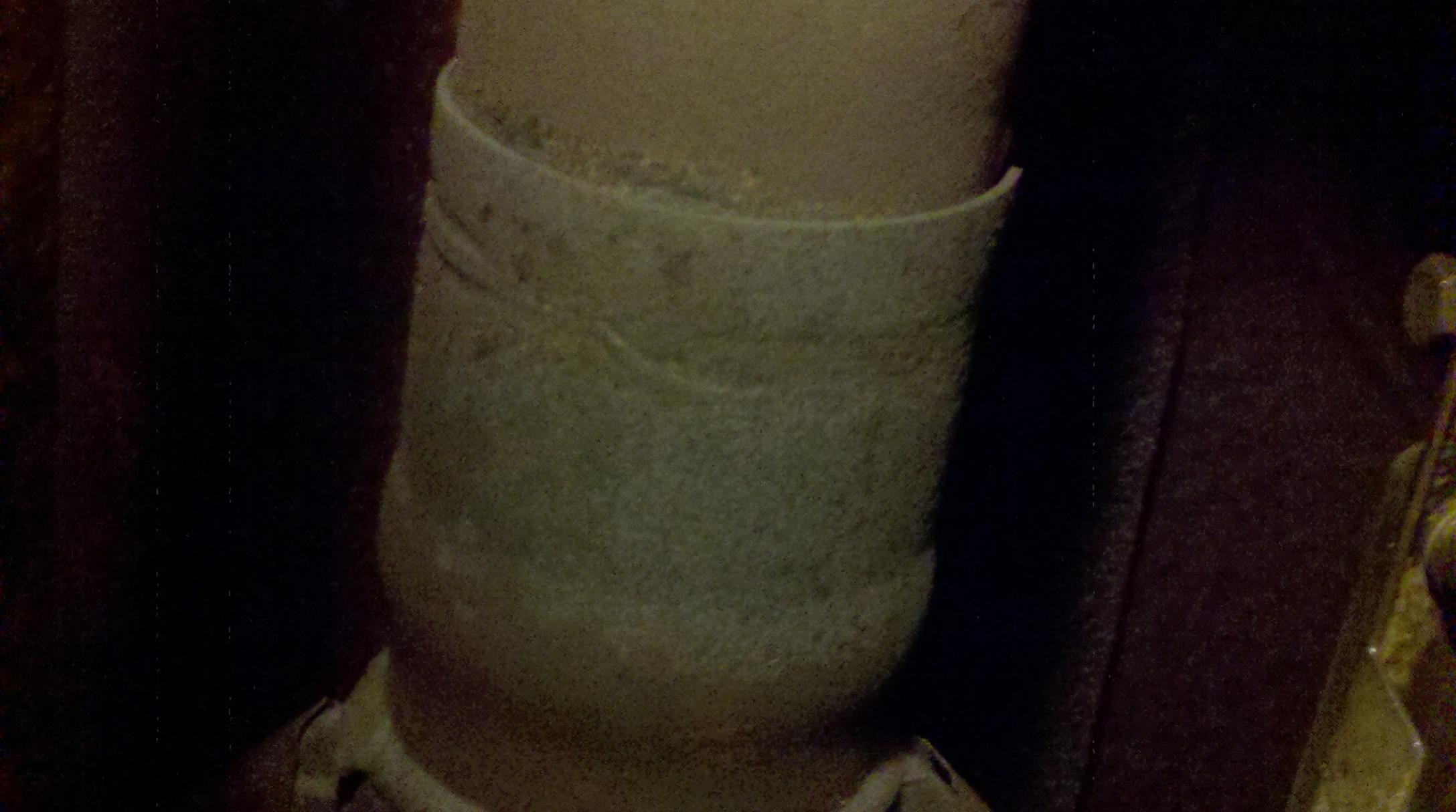

ok so im trying to change a y-pipe on a 89 gmc k1500 and i'm stuck with it right now. it doesn't look like it was welded together and there was a exhaust clamp form the y-pipe to the cat.
the y-pipe doesn't want to slide away from the cat. I've tried getting it to spin a little with no luck so far and i tried pushing it out with my foot for a little more leverage but that didn't work either.
anyone have any tips or tricks for getting the y-pipe to separate from the cat?
sorry for bad picture quality but i had limited space to take them in. The second picture is the top side of the pipe, I don't know why there looks like a huge gash in it though.

the inner pipe is the y-pipe right?
heat it with a torch like was mentioned.
another method is to crush the inner pipe with a air hammer, cut the pipe leaving a length that you can put a vise-grip on and then pull it free.
