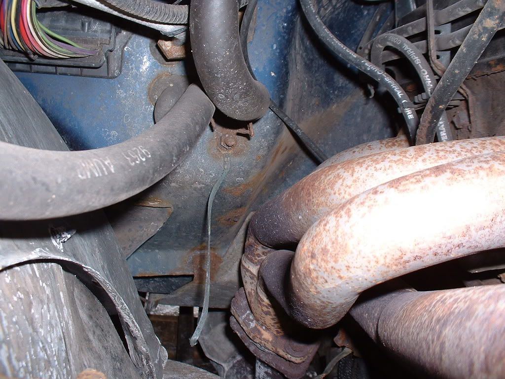

1995 chevy c/k 2500, 5.7 . Starts fine turn on lights engine quits. Thsnks
Old Nov 20, 2015 | 3:24 PM
hbrady's Avatar
Joined: Aug 2015
Sounds like maybe a ground issue. I'd check the ground straps, may have a broken one. I'm not familiar with how many straps there are or the location but here is picture of a broken one on a 94.
