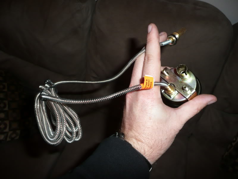

I found this pic on google, this is the kind of guage it is.

Installing the temp gauge prob into one of those plugged ports.......................
The thread of those ports might be straight threads for inverted flare tubing connections, eetc.
Versus pipe threads of the prob fitting.
Probe might be too long to go into either port all the way.
Using one of those ports might only read "dead fluid" since none is circulating thru an external cooler.
I can't recall GM ever installing a factory trans temp gauge so the ideal location is a toss up.
I think I would be inclined to install the probe to read the cooler line fluid.
Downstream of the cooler.

If you put the gauge in after the fluid has gone thru the cooler you wont be checking trans temp. Look on the drivers side right above the shft linkage for a pipe plug. You are going to have a plumbers nightmare of fittings to hook up whats in the picture. Autometer makes a gauge for this.

those plugs on the side of the tranny are actually pressure testing taps. a temp gauge should work there if it threads the same. i wouldn't change the threads on the housing. might make it hard to pressure test if needed.

I put mine in on a pressure test port and it worked great. That was in a 4l60e.
Yep, and he could also put a T into the trans, cooling lines on the right side of the trans. OR push the temp probe down the fill tube using an O ring and flared aperture cap to seal the tube instead of the dipstick.
