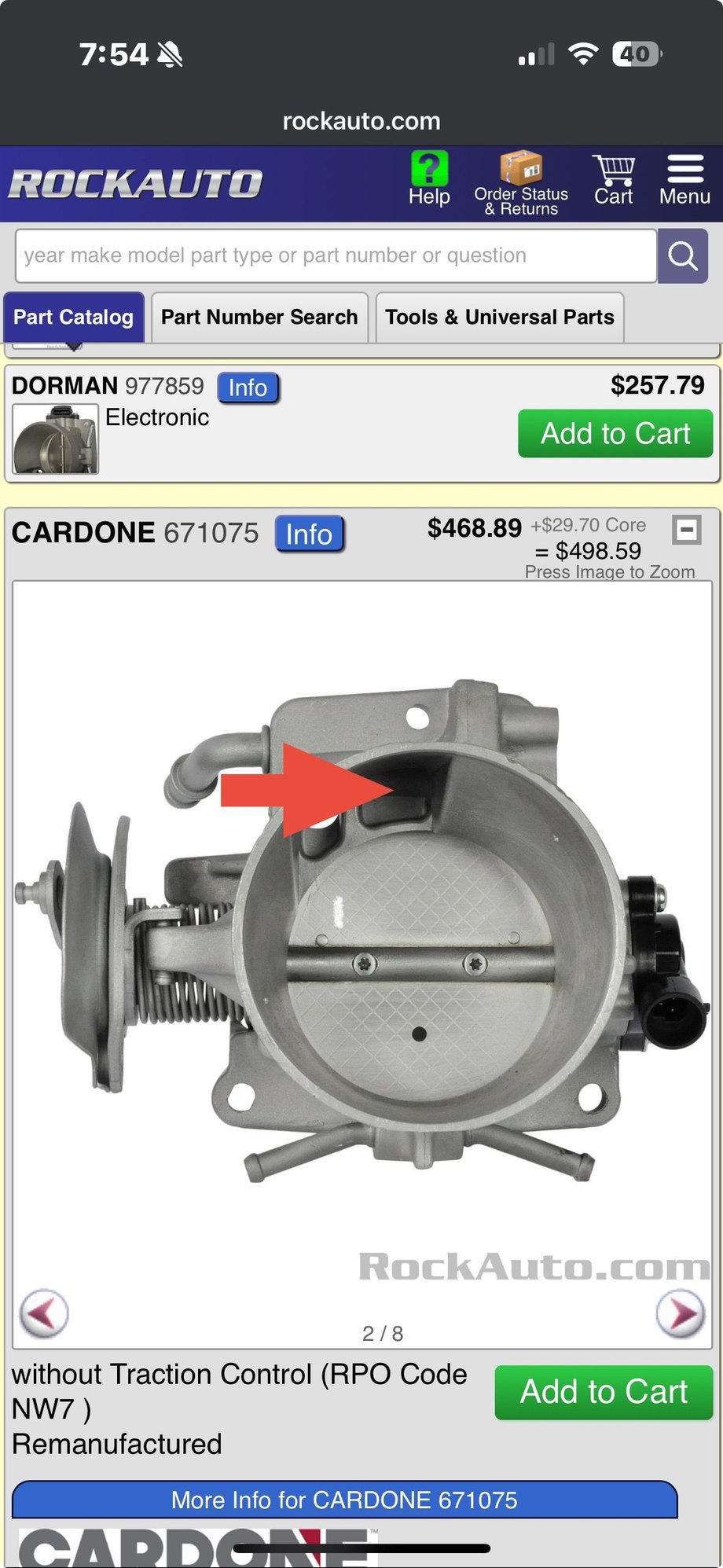

Remove the air filter boot.
Shine a flashlight into this bore [below] and have a helper turn the ignition to KOEO. Watch for movement of the IAC pintle & listen for noise from the IAC valve.
It may or may not move depending upon what the PCM sees from temperature sensors.
If it doesn’t move at key on, try cranking to start and see if there’s anything from the IAC valve.
If so, it’s fully functional and can be ruled out.
If not, try Tapping on the valve motor casing with the handle of a screwdriver - if it starts moving, it’s worn/corroded/etc. and needs replacing anyway.
If not, the next checks are with a test light at the connector - let me know if you need a connector pin out.

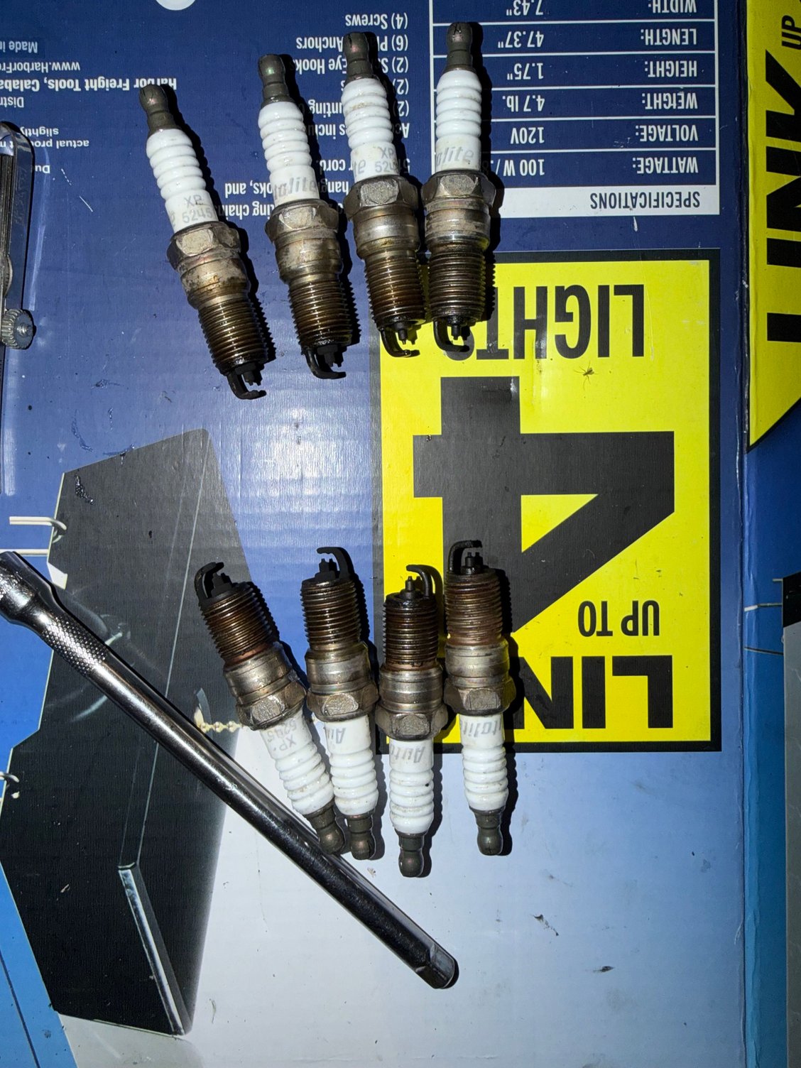

The IAC valve is brand new, since I had it with a warranty, and all of that is good, it’s working as it’s intended to from what I can see, there is multiple cylinders not firing when I pulled the spark plugs, I’m going to try new coil packs as well and see if that might fix it, if not then I’ll be completely lost, because I have basically all new sensors besides o2, but those are reading right on a scanner.
here’s a picture of the plugs, and these have less than 1k miles, and I gapped them to .040 thousandths and installed them maybe a month or two ago. The top is driver side, the threaded side is going into the block, so top right cyl 1 bottom right cyl 2 etc.

Those plugs are definitely fuel-fouled; but we know the plugs must be firing because you can keep it running, even if it won’t idle on its own.
It’s unlikely replacing the coils will resolve the problem but you can try.
Are you actually hearing/feeling it misfire or is it just recording misfires on the scan tool? If it’s just recording them, I wouldn’t spend any more time focusing on them because it’s probably a secondary problem caused by the lack-of-idling.
What does your scanner read for fuel trims? Ideally, long term and short term should be within 10% of zero at all times.
