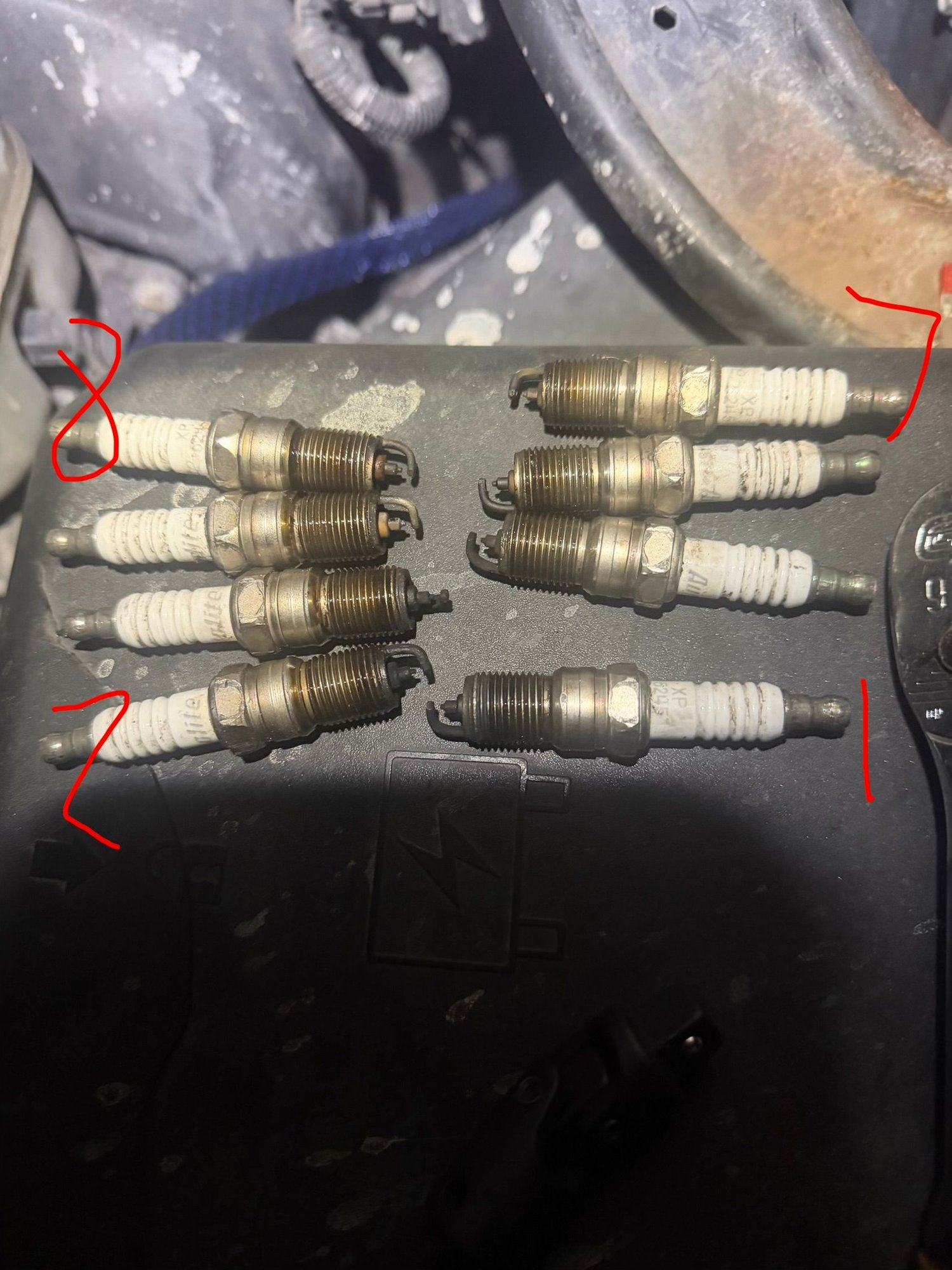

Title is self explanatory, but I replaced the fuel pump since it all led to it, I pulled a couple not all plugs and they were tan, it would always crank no start the 1st crank, but 2nd crank always started right up, and now won’t start unless I push down the gas pedal a bit, if I let off, it dies. I’m thinking maybe a vaccum leak, and I’m gonna try to get a smoke machine or whatever it is to look for it. Any ideas on where to start?

These are the plugs after I pulled them, self explanatory bottom right cyl 1 bottom left cyl 2 and then 7 and 8 also numbered
