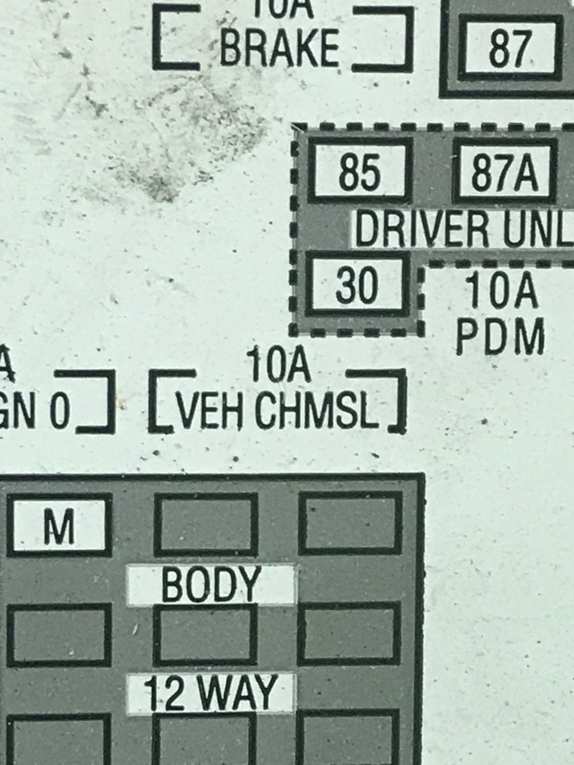

Check this fuse on the drivers door fuse panel 10A VEH CHMSL
This fuse is for power to the passenger door panel
