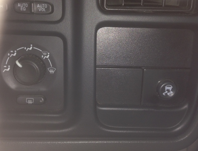

I get this too on my 2005 Tahoe. From what I have read, it is an ABS sensor on the hub. Too cold for me to replace it just now, but in the meantime you can turn it off pretty easily. Just hit the button on that looks like a car spinning out of control. The bad part about this is when it happens as you start into an intersection, causing the car to stall. Turning it off can save you from that.
As far as replacing it goes, I'm not sure how to tell which of the four is bad, but I'm going to start with the hub that I last worked on. These are about thirty bucks on Amazon. http://a.co/fhR0vON
