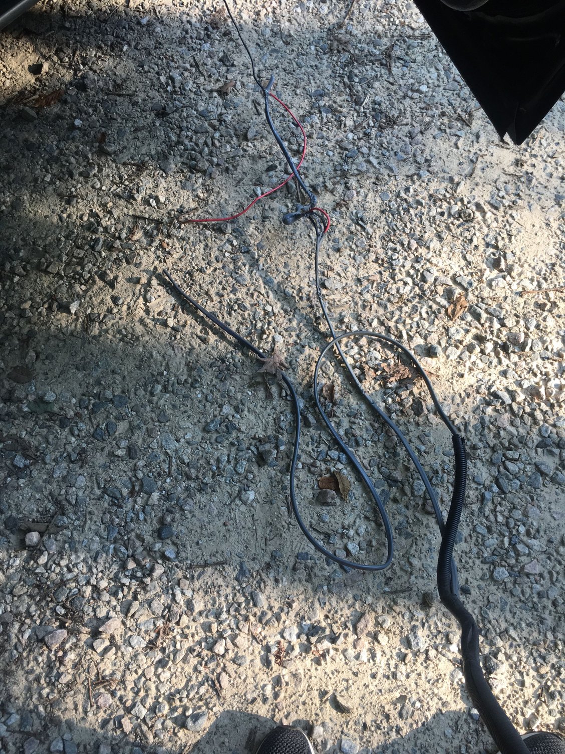

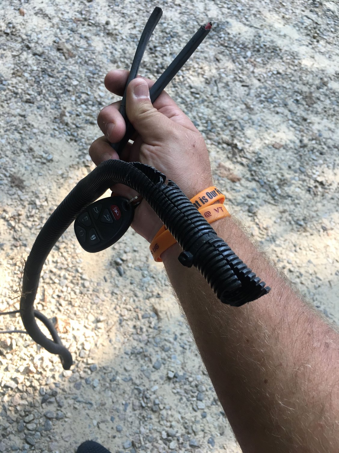

We were driving out of town and I backed up to get turned around. I heard something pulling below and finally got out. I found a line of wires (had a black plastic tube covering and gray outer layer with a red and black wire) had torn out from under the passenger side running board. Drives fine and everything seems to work. Any idea what it might be? It looked to be going from front engine area to behind rear wheel on passenger side just up under the running board. I’ll post a picture later. One end looks like a clean cut that was never attached. Scary to find when out of town!

Default Pictures

Could it be extra wires used for electric running boards? I just have the basic ones anyways.

Were they attached at either end to you vehicle? If everything is working, they may not be yours.

Yes, they’re definitely tied under my vehicle. I finally found documentation that it’s wiring for the tow package. GM has the brilliant idea to leave them disconnected. Somehow they fell out of the engine bay and tangled on my tire or something. Great design, GM. So I’m going to cut them and tie them up until (if) I ever need the tow connections.
