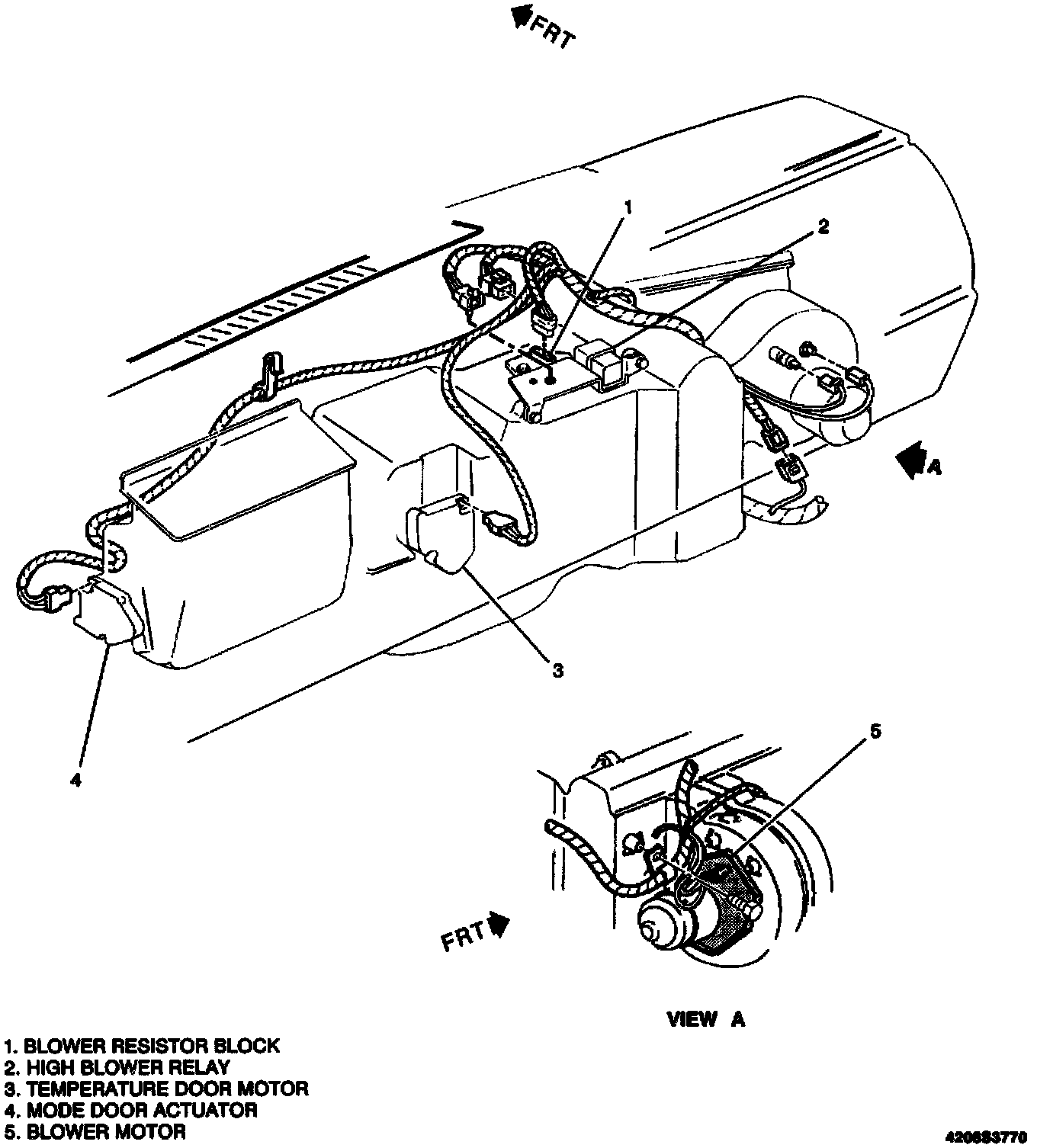

If it helps, this diagram on the link I gave you already kinda shows where the TEMPERATURE actuator is. The actuator is the component pointed to by the number 3, and looks to be around the center of the dash. I know the mode actuator is the one on the left, above and to the right of the gas pedal, as I've looked at that one on my 1996 C1500. I *think* there are some linkages to it, but it may just sit over the shaft that moves the door and engage with it directly. I've had issues with MODE on mine (not moving from floor output to vent output), which is the other actuator.

Yes, and thank you for providing that schematic previously. That's exactly how I'm seeing it.

So, the mode actuator on the left appears to be spinning well, but the linkage looks wonky compared to a diagram. The blend actuator in the middle also appears to be spinning well, but temp stays hot when dial is turned to cold. There is another actuator next to the blower that doesn't appear to spin no matter what I activate on the control panel. Is this for the recirc?
