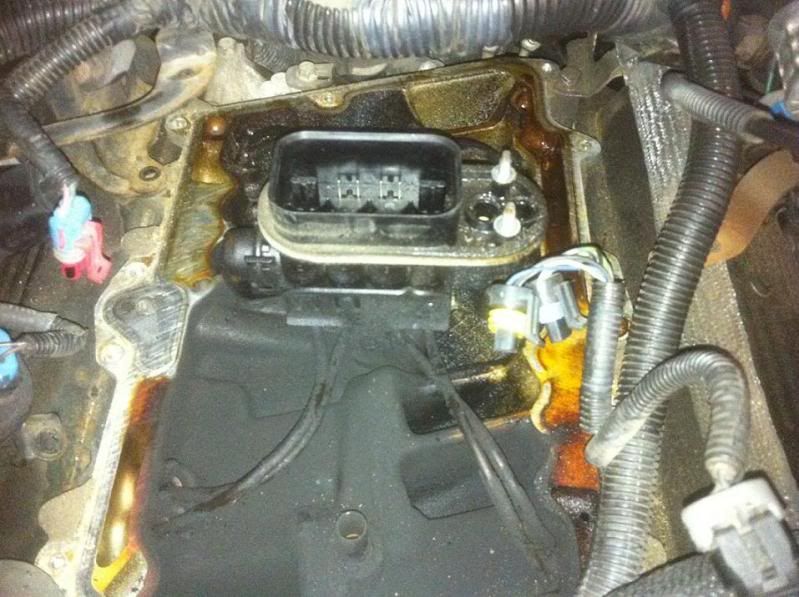

So I’ve read on several forums the fuel pressure regulator is usually the problem so, I ripped the upper intake manifold off to replace it, well once the Upper Intake was off I notice there was gas lying in the back of the manifold mostly on the passenger side, and directly under the spider injector on the driverside. So I said the hell with it, It’s apart and it looks like the poppet valve maybe leaking or injectors, so I just bought the MFI conversion kit from GM and installed it along with a pretty good plenum and manifold cleaning as well and new gaskets, put the truck back together…..Truck Starts right up, I’m Happy YES problem solved CHEERS, turn the truck off does the exact something. So at this point I push the gas pedal down start the truck back up, pull it out of the garage and take it for a long ride; the truck is running great, so I get it home and turn it off thinking this may help it in some way, turn it off and try to start it something turns over nothing, press the gas pedal down starts up rough and then comes to life. Sigh, so by now I’m ready to rip the gas tank out in a hulk rage and throw the fuel pump across the street.<O</O

http://i57.photobucket.com/albums/g2...boy/Tahoe1.jpg
http://i57.photobucket.com/albums/g2...boy/Tahoe2.jpg
Thats the Upper Intake Ill take pictures of the Fuel Pump is you guys want.
