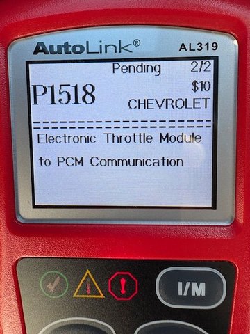

I’m having problems with my Tahoe going into limp mode, code P1518. I appreciate any insight and have posted the history below:

Current and Continuing problems with code P1518 & reduced engine power-Sept. 2022-the present ( November 2024, 190,000 miles)
-When this happens, it is always after the Tahoe has been sitting in the garage for a few days. It goes into reduced power mode within the first 10-15 minutes of driving it.
-On the dash, the transmission light comes on. I clear the code and it drives fine the rest of the way.
I appreciate any insight anyone could offer.

Every single time I have had that message pop up (along with the slow as hell acceleration, lol), it has been when starting the vehicle after its been sitting for a couple/ few days. The battery will usually measure a couple volts low, and/ or the terminal connections at the battery will be slightly loose or corroded. My quick fix (laziness or can't afford to replace the cables or battery just yet) is to pull over, shut off the suburban, pop the hood, and give the battery cables a little twist in the tightening direction, or if I have a little adjustable wrench, I'll tighten them a little bit on the battery. I'll turn the key on, wait for the fuel pump to pressurize ( a couple seconds), and then it'll start just fine, full engine power restored... until next time :-)
Edit: P1518 pops up also, half the time, and illuminates the check engine light. But it'll go away on its own after driving it a couple times
