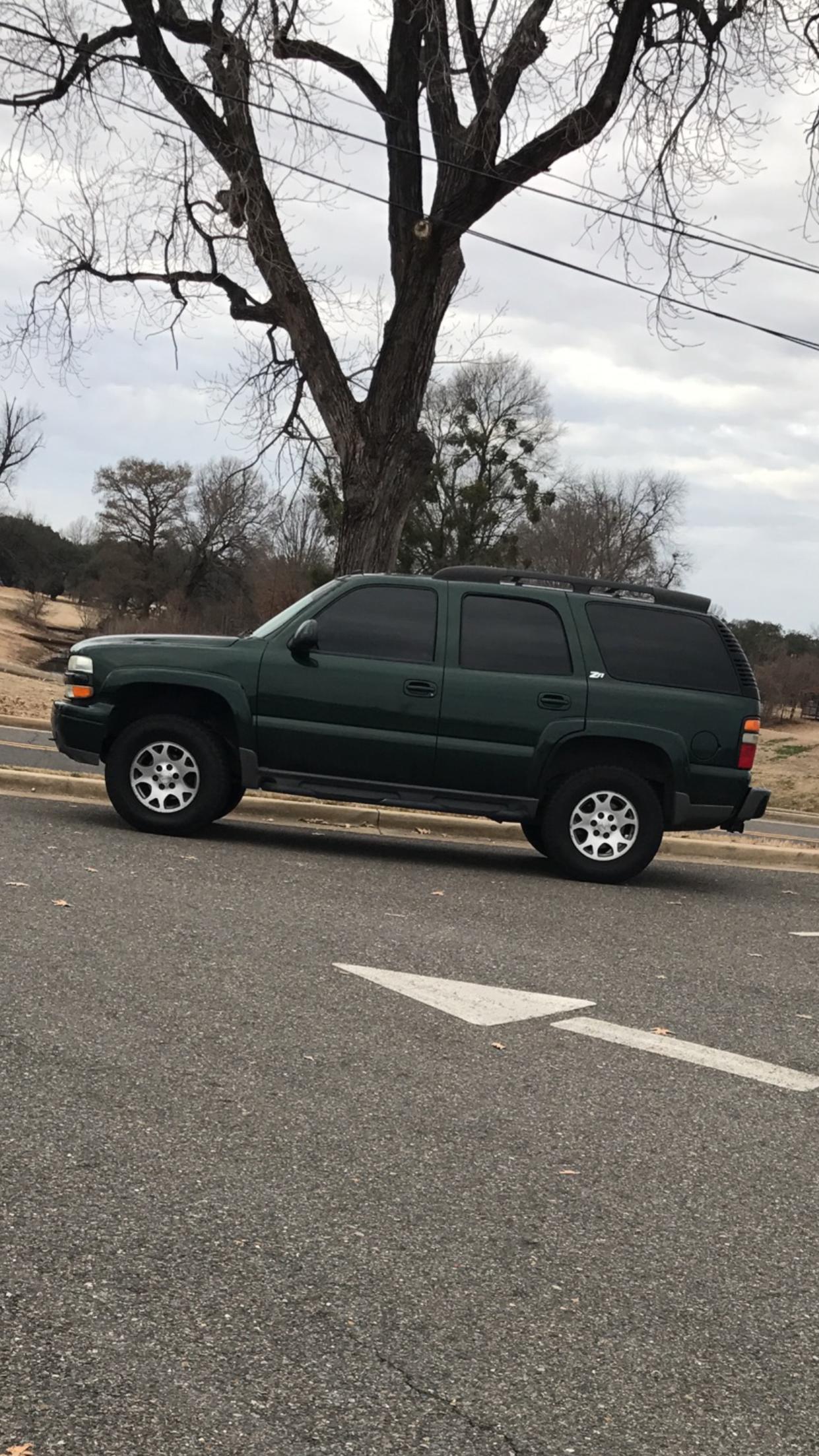

So I bought this Tahoe off an older woman who is the original owner from 2004. Had been sitting up the past 2-3 years. 185k miles.
