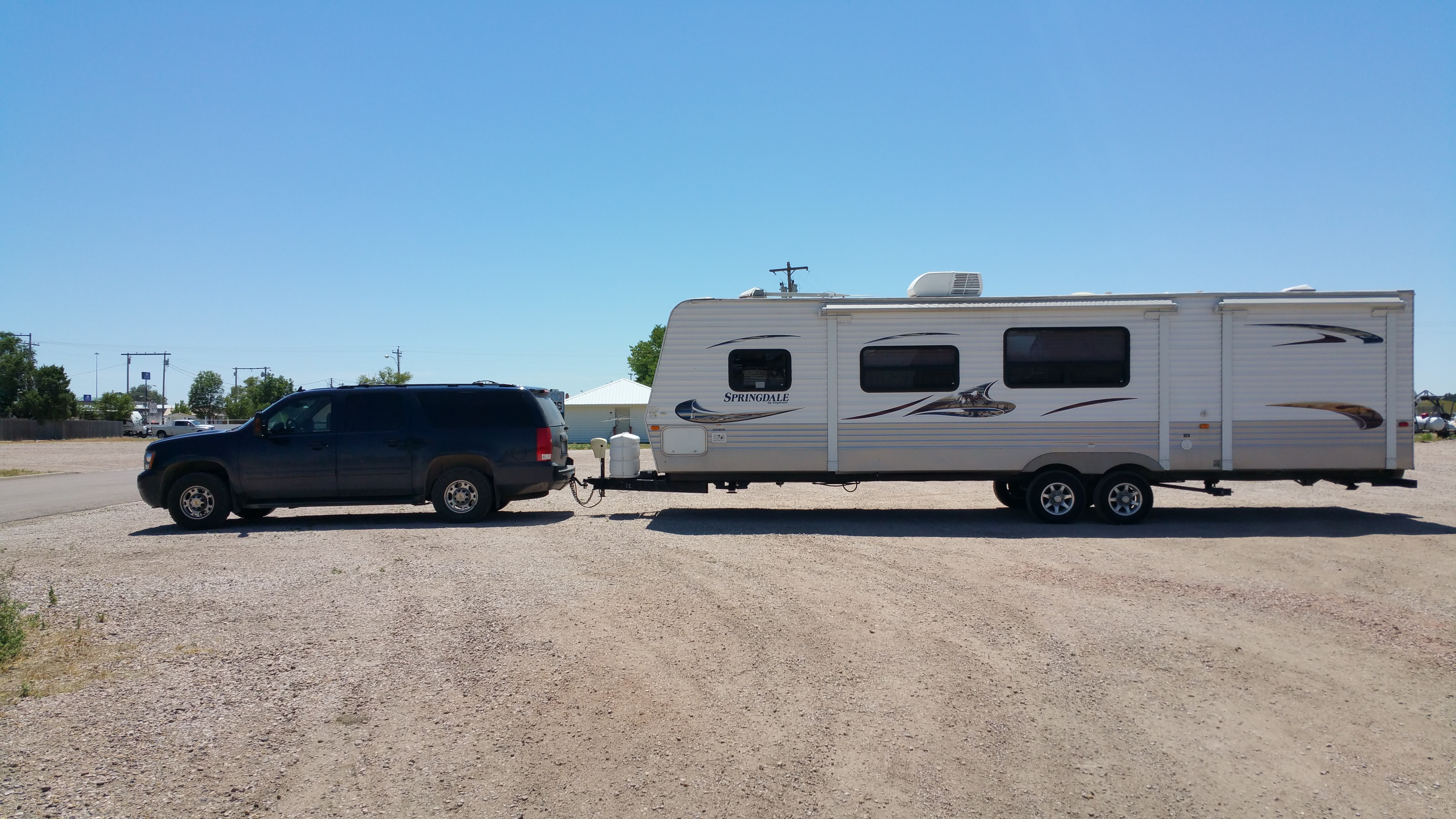

Well, I pull this with my 2008 2500. 35 feet, 8600 lbs when fully loaded and empty tanks.
The 2005 would have even better capability, due primarily to the receiver. According to the owners manual, a 2005 with the 8.1 and 4.10 is rated to pull up to 12,000 lbs. Though personally, based on my experience with my rig, I'd be nervous going much above 10k lbs on the trailer weight. The shorter wheelbase of the Suburban is the main issue.

Thanks for the info! The more I research on the Suburban the more I like it. I hope I can get mine to tow as straight as yours is in that pic you posted. What kind of hitch are you usin?

Well, I'm using a Curt hitch/ball, and that's about it. No sway control, no weight distribution. It tends to make folks' heads explode. I'm breaking quite a few rules.
For the first time, it did get a little squirrelly driving up I-25 in Wyoming back in June. I'd estimate 30-35 MPH cross-wind gusts. If I hadn't been only a few dozen miles from my destination, I probably would have pulled over. First time that's happened, and I've logged about 10,000 miles of towing that trailer, including the Eisenhower Tunnel (11,000') and Powder River Pass (9,666'). Still wasn't that bad, about a 4 out of 10 on the white-knuckle meter.
