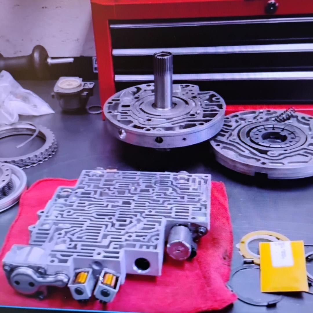

Trans torn down. It seems someone has rebuilt it in the past. Some damage my have been due to that.
Reverse input drum - Has bowed outward lugs along with the corresponding lugs on sun shell - Builder has seen it before. Rare occurrence. Builder is unsure how this happened
Need to replace reverse input drum.
Sun shell is replaced as part of normal rebuild with upgraded band.
Forward drum has worn lugs - Previous builder may have left it like that - Need replacement - Has good used part going to use

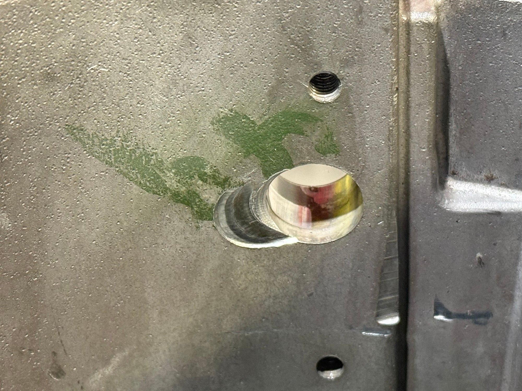

Case - Has a groove worn into it from bowed lugs on sunshell and/or reverse input drum / severely worn band anchor pin and hole - Case needs replacement.(?)

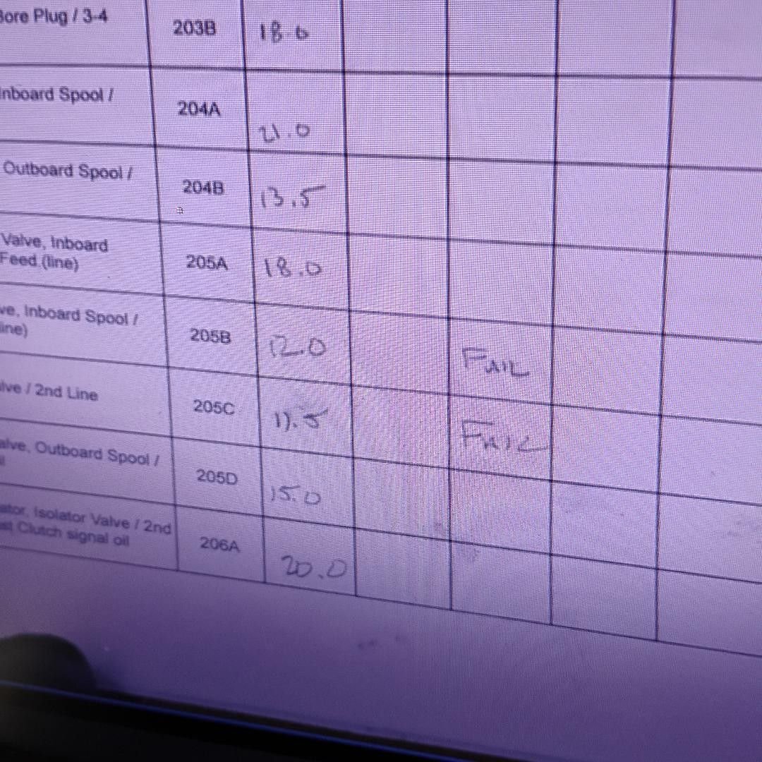

Valve body may need replacement or possible repair.- 3/4 relay valve reads borderline pressures. Builder likes to see around 15.0 on reading

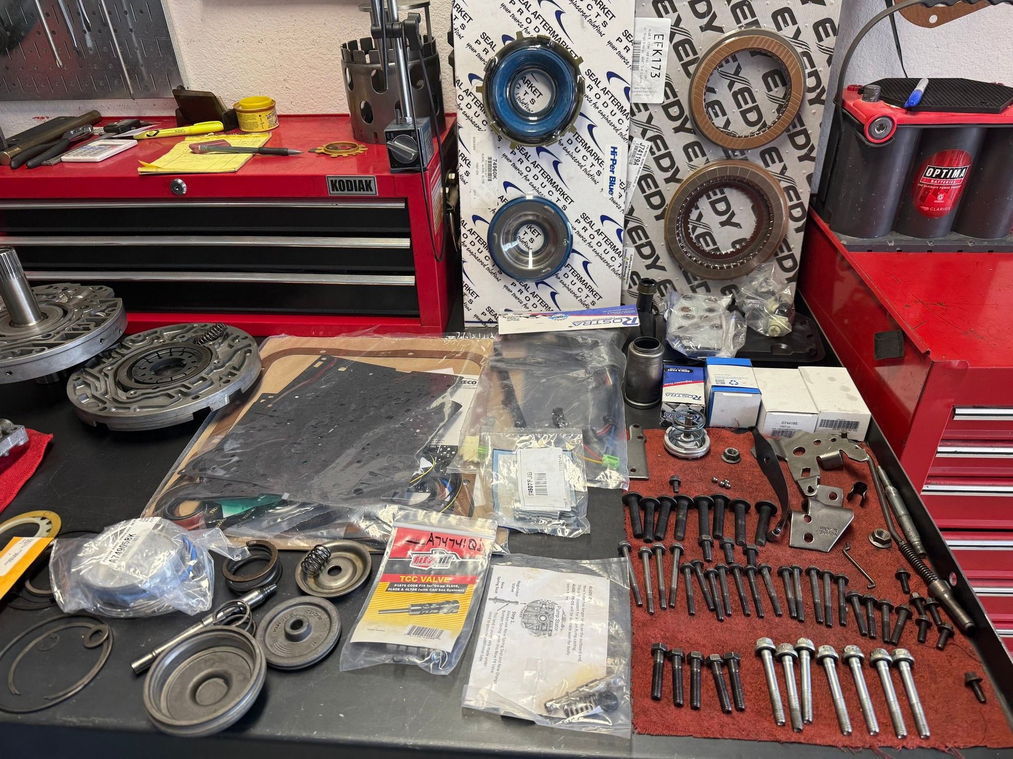

New parts

the complete teardown of my 4l60E trans if interested.

Transmission shifts beautiful now.
