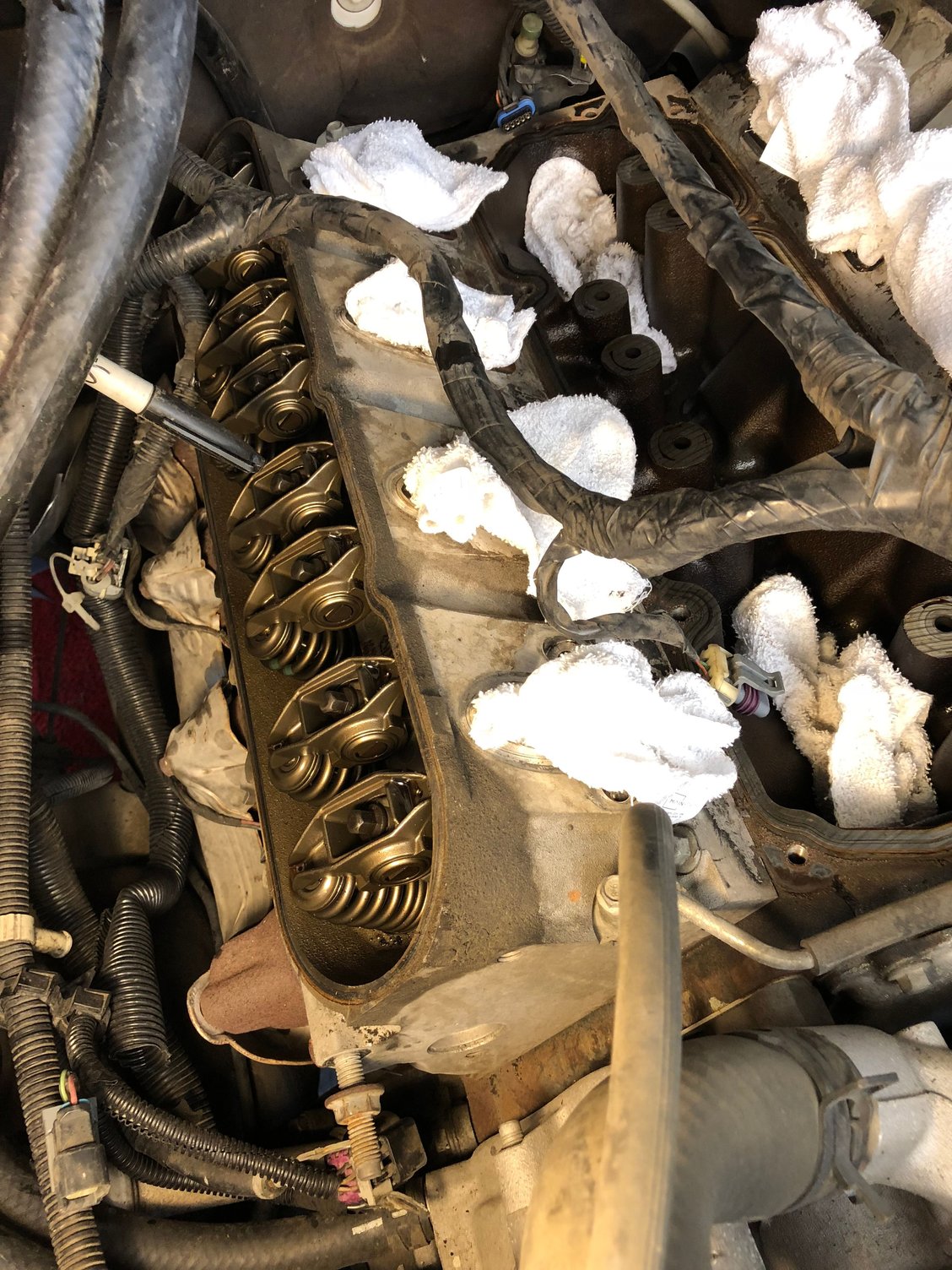

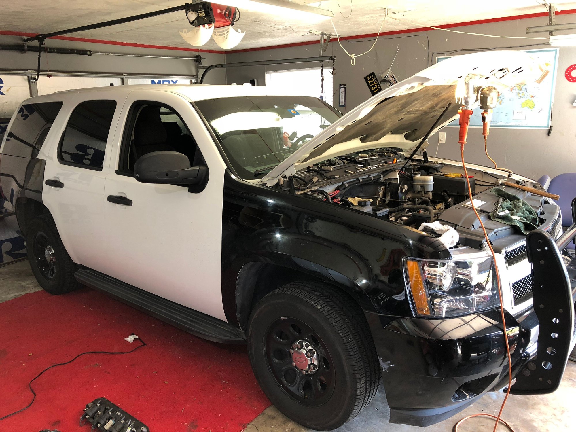

Recently 11-2018 was driving my 2007 Tahoe and the #4 exhust lifter stayed in 4 banger mode.

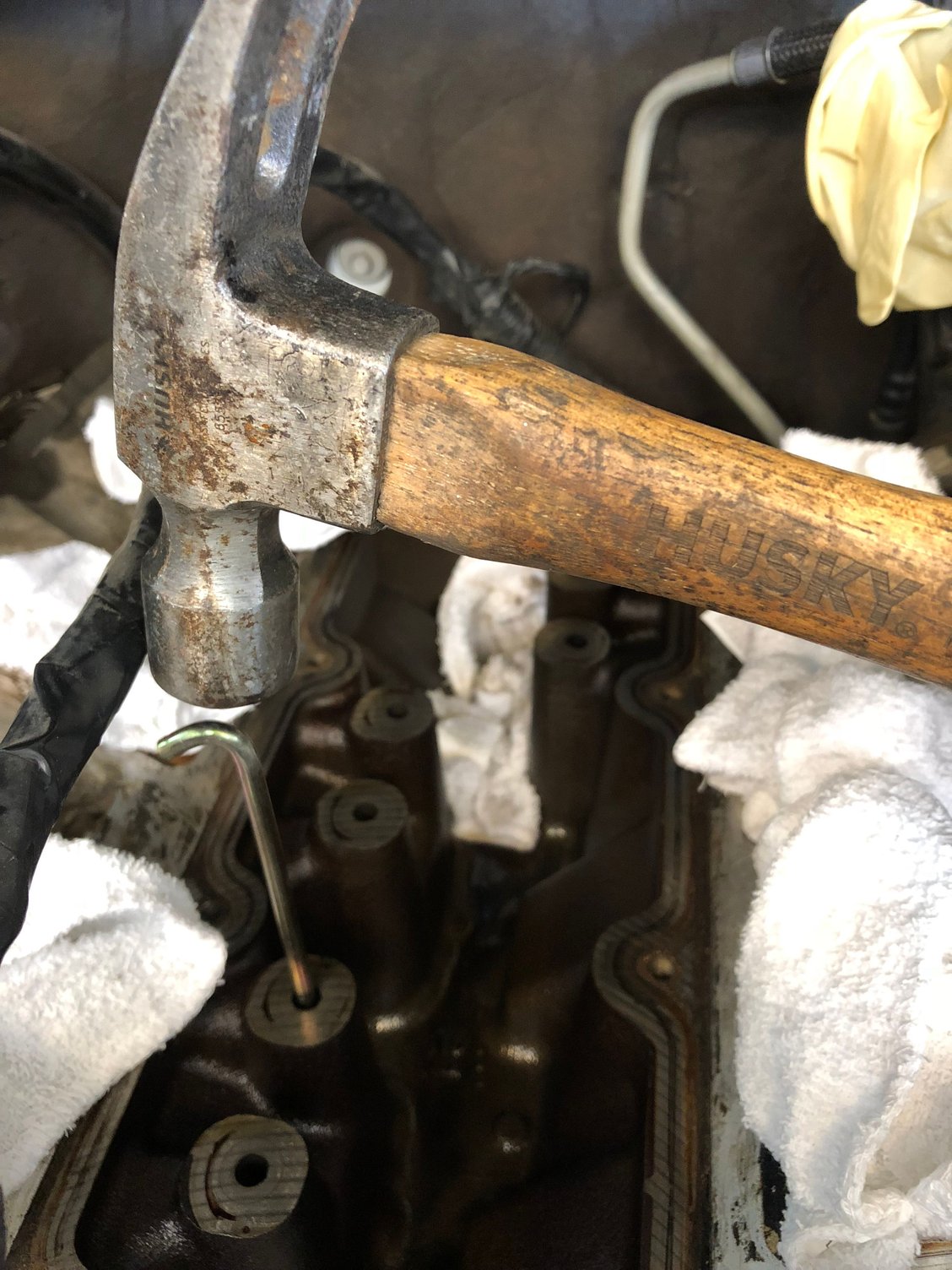

Pulled the intake and did the lifter smack trick and she popped back.
