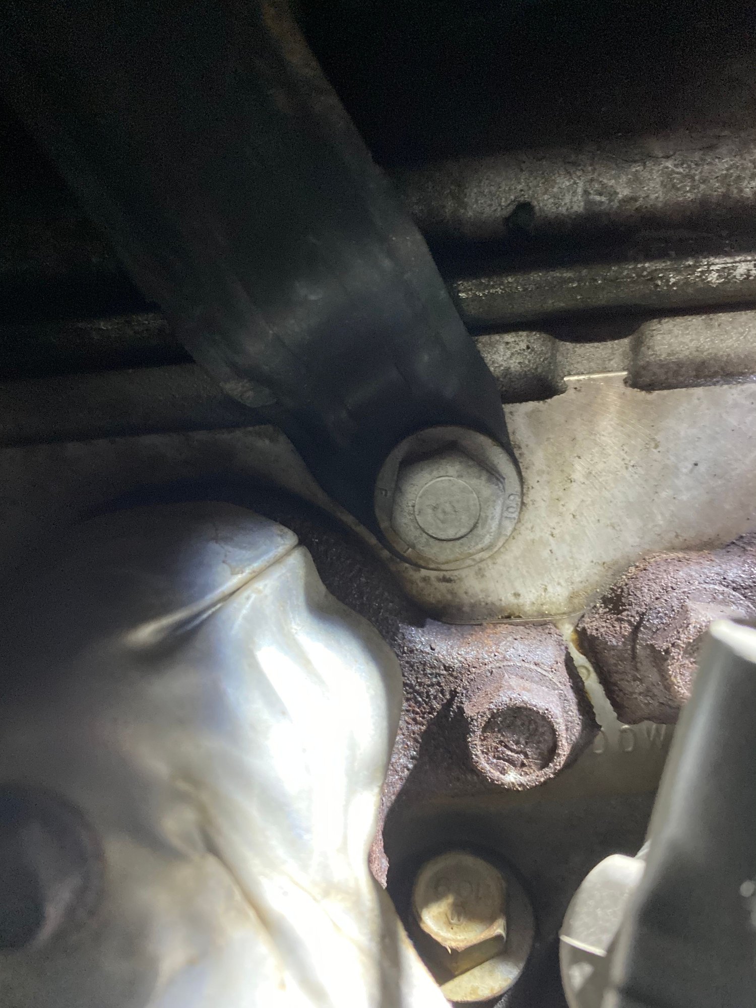

I think I found the issue....not sure how the stock OEM GM exhaust manifold it...but is this a crack or is this how it comes from factory?
EDIT: now that I'm looking at the pic, the gasket seems fine?! I don't know, I've exhausted my backyard mechanic troubleshooting. My neighbor suggested a possible vacuum leak...but I don't even know where to start looking for a vacuum leak on any car, lol

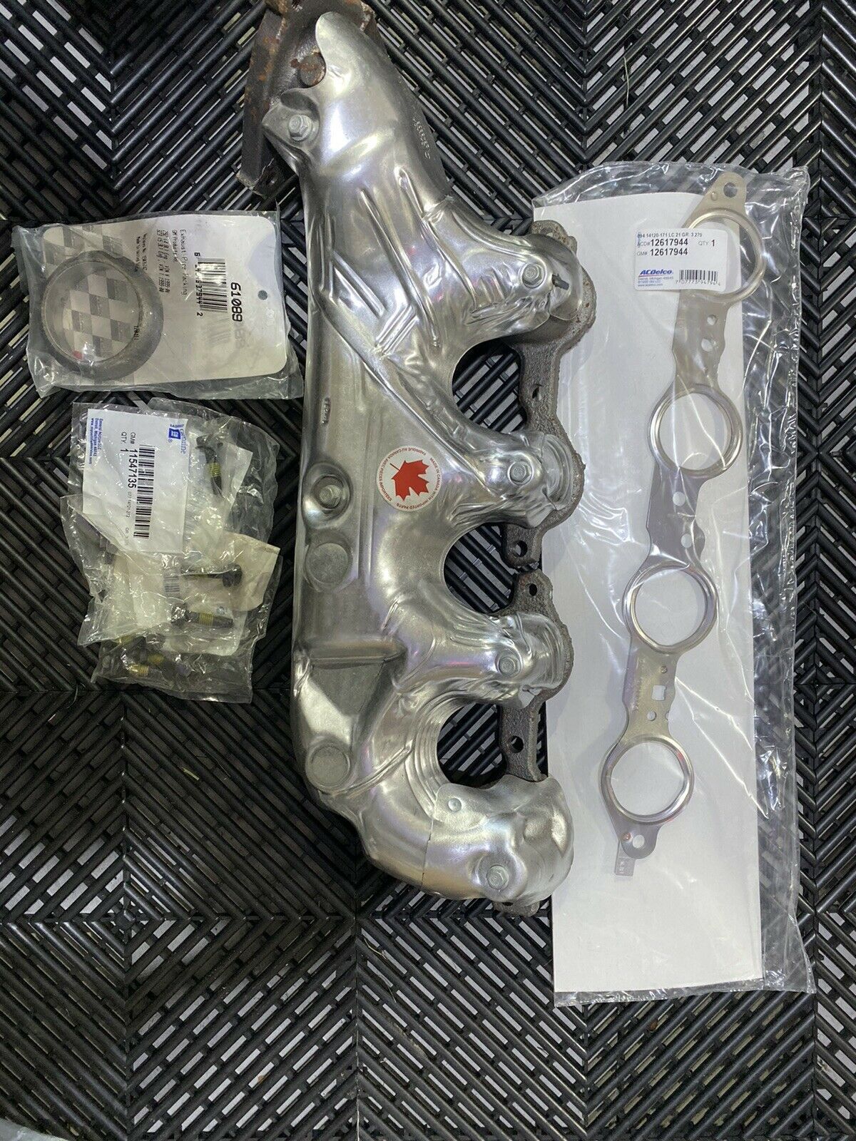

Nevermind...I think thats normal...here is an OEM exhaust manifold in ebay, I think its the same part number
