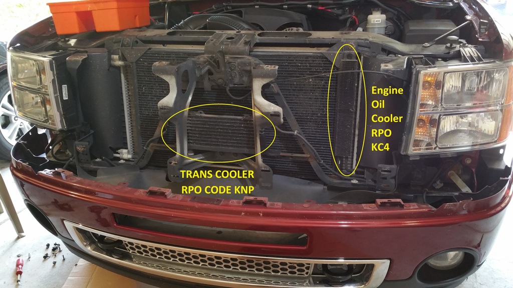

Look on your glovebox sticker for the RPO codes below, or just look through your grille.

Intheburbs Thanks for replying,
Dealership where I bought car was no help in figuring this out... they could only tell me what fan I had.
