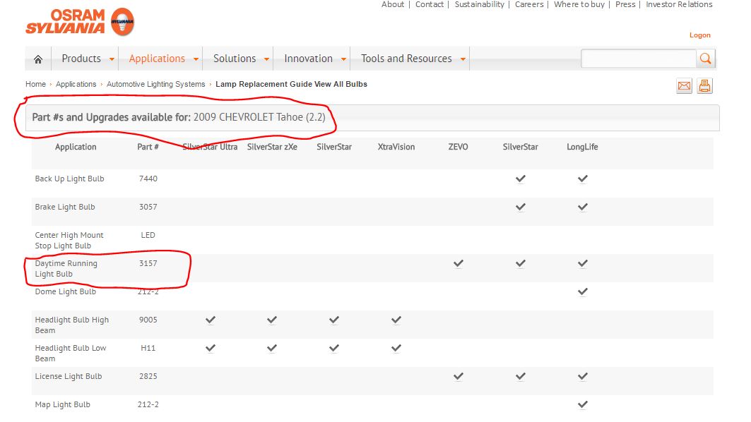

According to Osram Sylvania , the 3157 is correct for the 2007 and up. The 4114 is the the 2006 and down..
http://www.sylvania.com/en-us/applic...s/lrgmain.aspx
