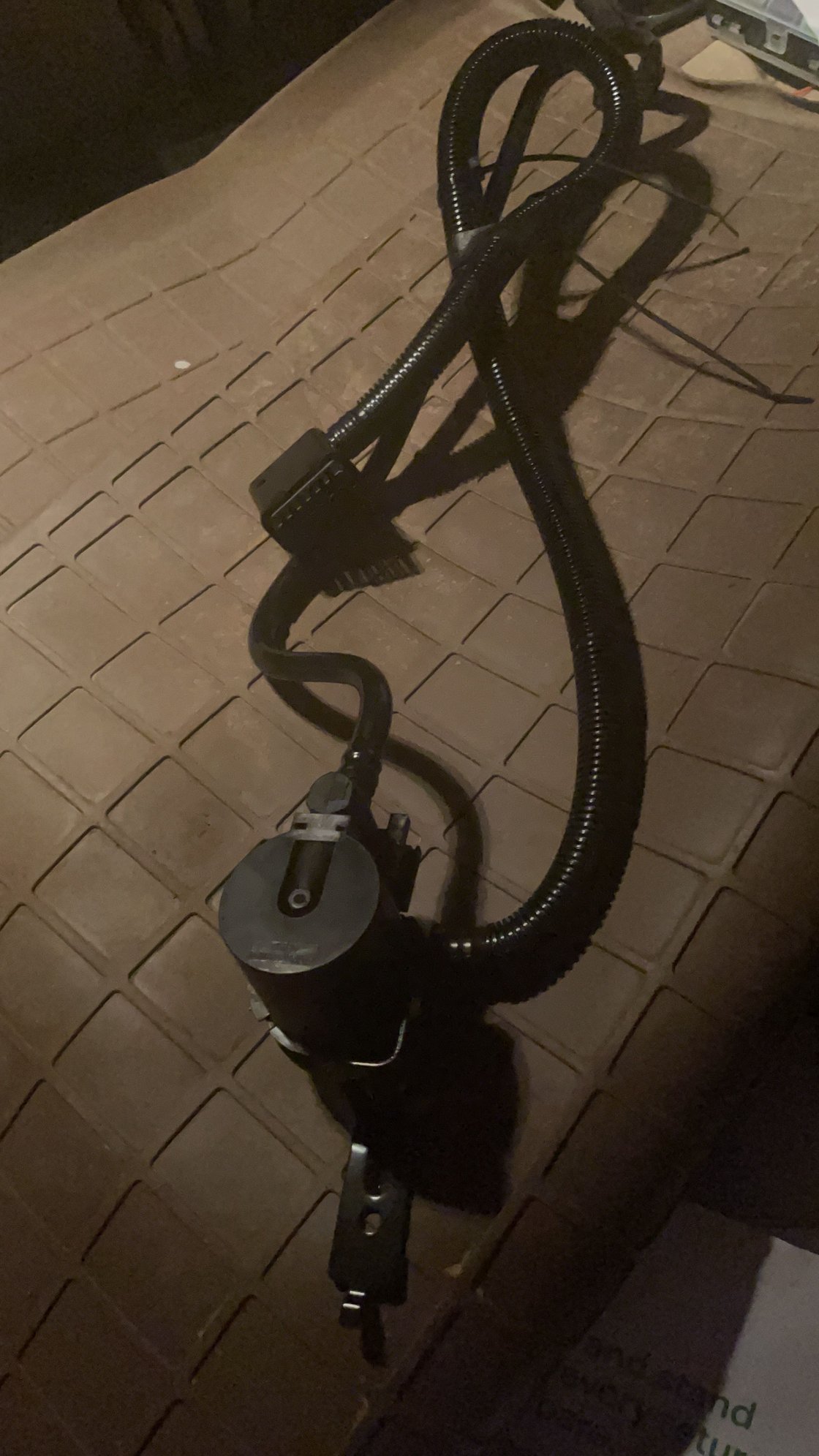

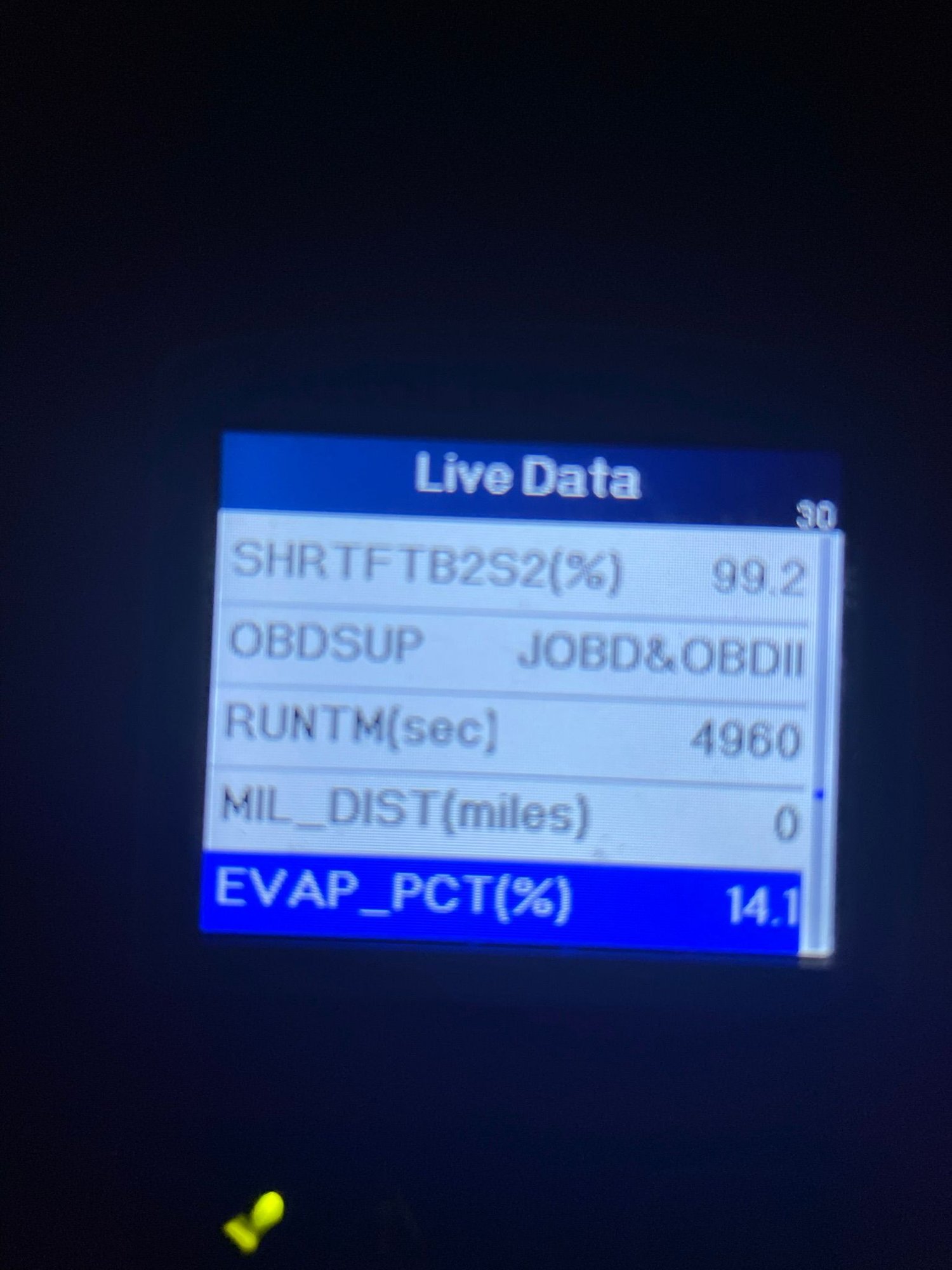

I have 24 inch wheels and the front was rubbing the inner fender well liner right above it was my K&N air filter it was sucking up the bits of plastic from the fender well liner so I removed the air filter and the intake tube as well as the mass air flow and cleaned all that I also wiped the throttle body down no cleaning spray was used it terribly dirty! That cleared 3 codes!! I had the P0449 left to resolve! I took the EVAP vent solenoid down and checked it giving it 12v to hear of the solenoid was opening and closing. It was I removed the hose and washed it out let dry completely and put it back the code cleared for about 30 miles it came back! Next I replaced the EVAP vent solenoid as well as the two hoses connected to it 1 is just a vent sitting beside the gas fill neck and the other goes to the canister it came as one unit. I also had buy a new connector because the new solenoid uses the updated connector. I install and properly mount everything back like it was originally and I still have the code!! What is my next step I’m past due for vehicle inspection and tag is going to expire soon!!! Also I baby my truck around and I just hit 200,000 miles at about 200,200 miles is when my engine lights started!
