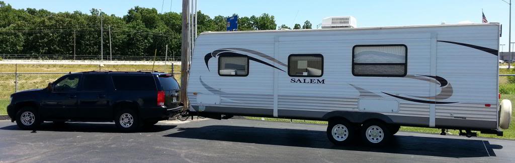

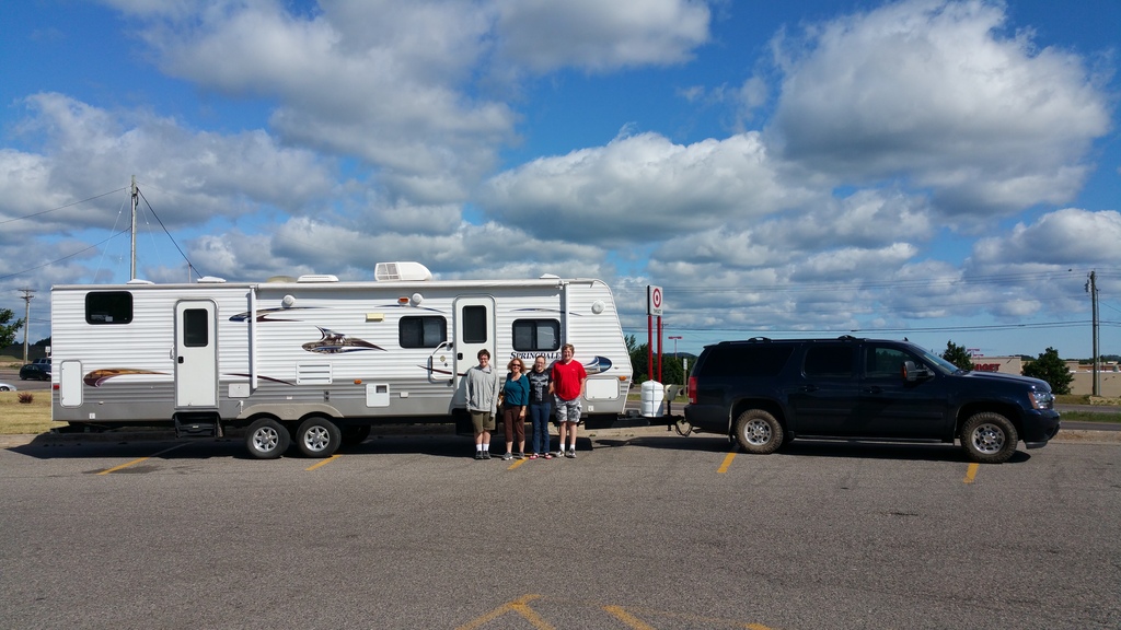

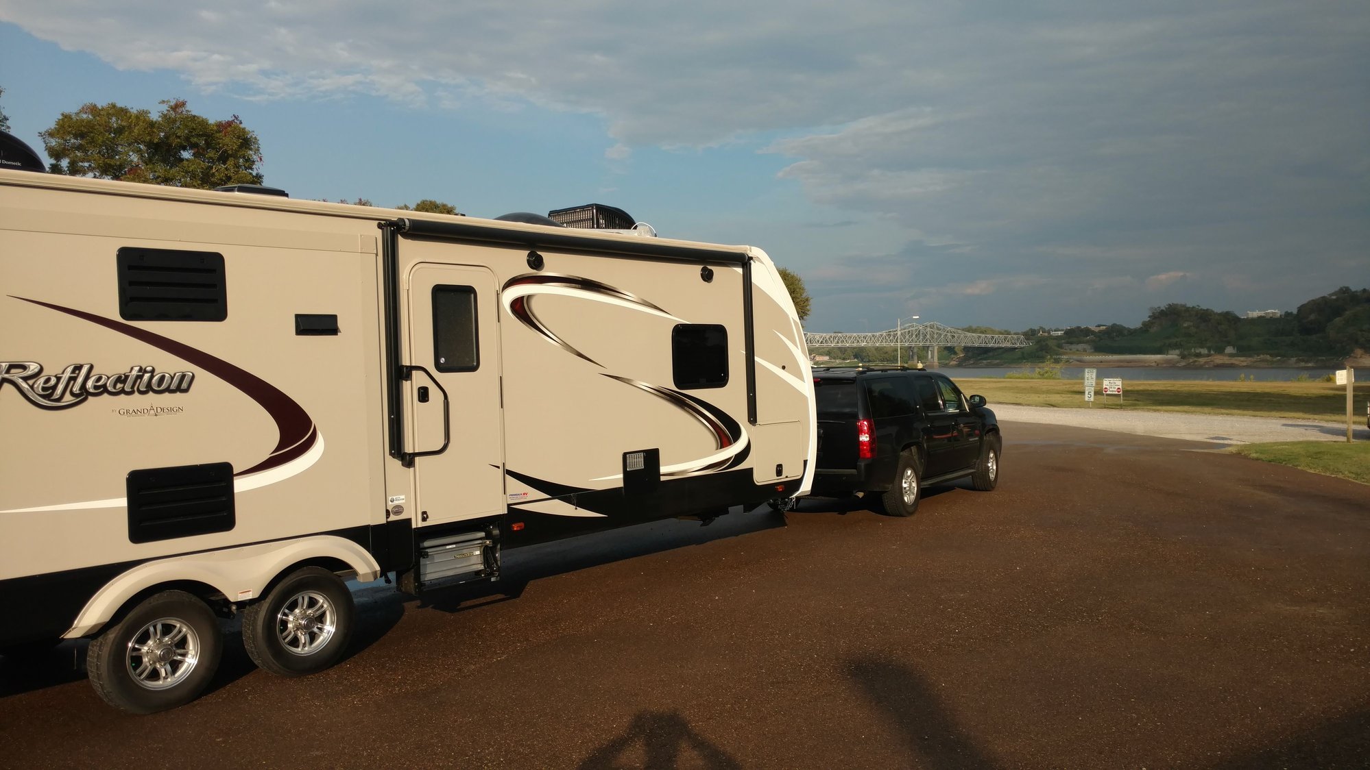

I've been towing a travel trailer since 2007. I've towed four different trailers (all at least 26' long and over 5,000 lbs) with both my half-ton '01 Burb and my '08 3/4 ton Burb. We live outside Detroit, and our destinations have included: Grand Canyon, Yellowstone, Colorado, Utah, Alabama, Florida, Virginia, Maryland and the Upper Peninsula. Over the last 8 years, I've racked up about 20,000 miles of towing across the country, including a few runs through the Eisenhower Tunnel in Colorado (over 11,000 feet).
Again, these are awesome trucks, but they're not invincible. They are, however, very conservatively rated by GM. The 2500s I mean. The main reason I upgraded to the '08 is because I broke the '01. Several times. While towing. While on vacation.
