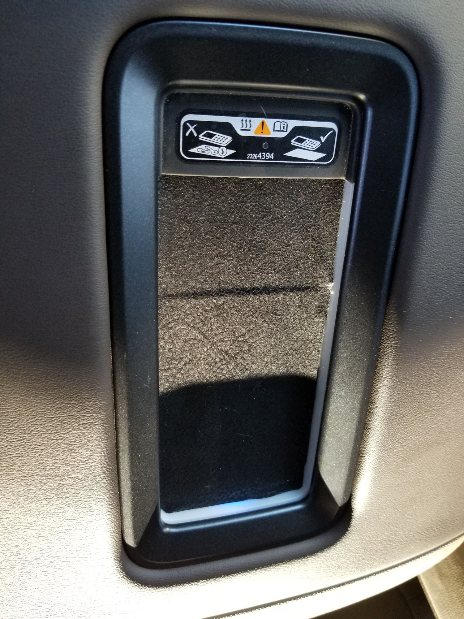

you have 2 distinct problems with wireless charging in GM vehicles. I also use a case on my S8+.
#1 the GM pad is almost 2mm thick, this makes wireless charging difficult and less effective.
I replace the rubber pad with a leather like material, minimize this thickness.
#2 the charger is installed to far forward for larger, phones to charge.
If you remove the outer bezel you can see how to remove and modify the charger Pad to accept larger phones, maximize phone width 3.1 inches. by moving the charger positon all the way to the back of the Bezel.

remove console lid, bottom cover with trim tools, it just clips on.
remove 9 screws holding the outer bezel down. remove remove rubber mat , and adjust/remove as needed for your phone.
