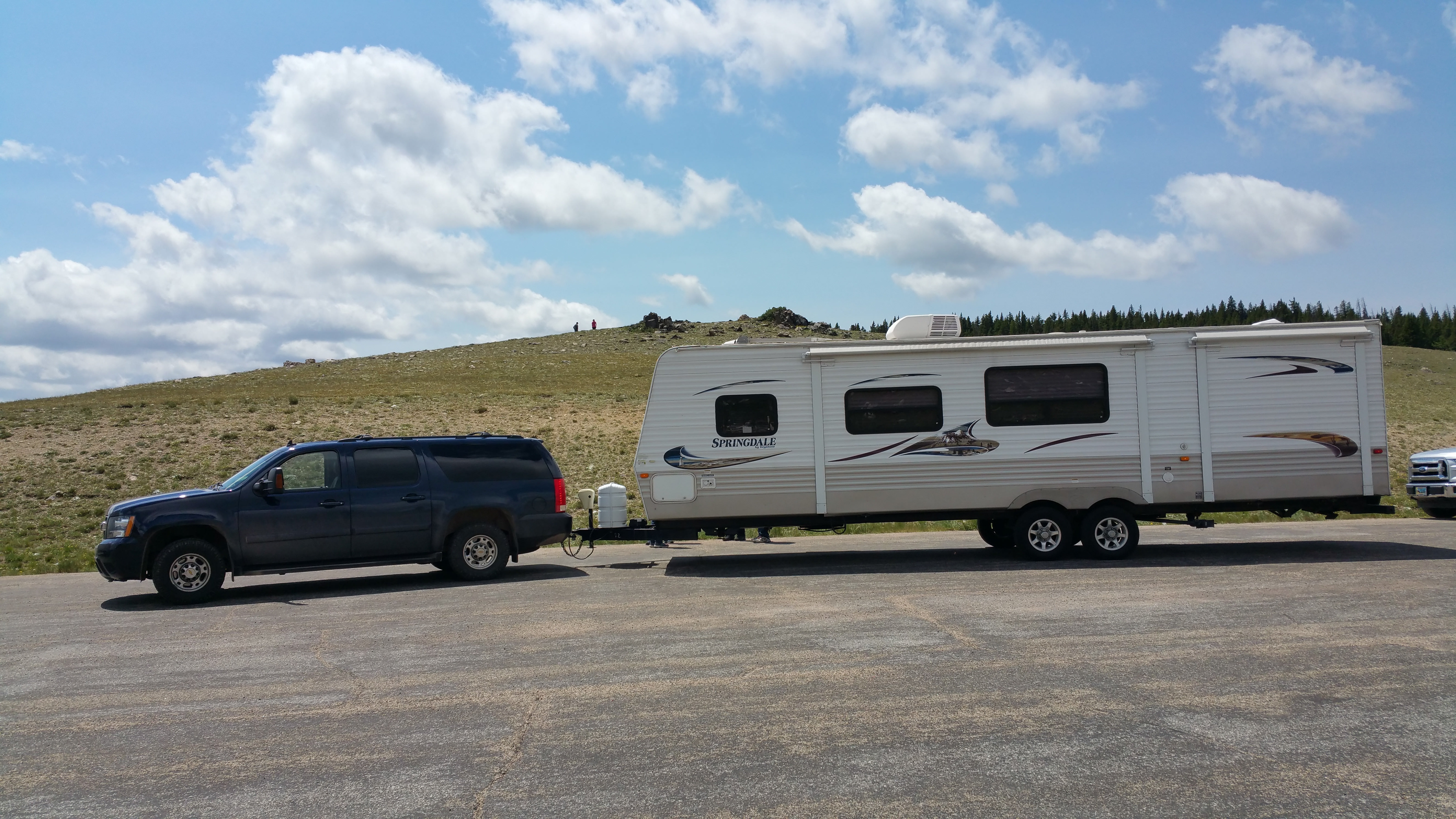

For a 35-footer, if it was me, I'd look for a 2011-2013 2500. The plain truth is that a half-ton truck is not up to towing that large of a trailer. If you're going to acquire a new vehicle, get one that is properly suited for the task. Going from an '09 half-ton to a '15/'16 half-ton, in all honesty, would be a negligible upgrade. A 2500, however, would be a huge upgrade.
Most people mistakenly believe that the 2500 is the same as the 1500 with just a few beefed up items. In actuality, once you remove the body, it's a completely different truck -frame, axles, engine, transmission, suspension, brakes, etc. are all different and upgraded compared to the 1500.
This is the behemoth we pull, and we've taken it into the Rockies on multiple trips. Here we are at Powder River Pass, elevation 9666':

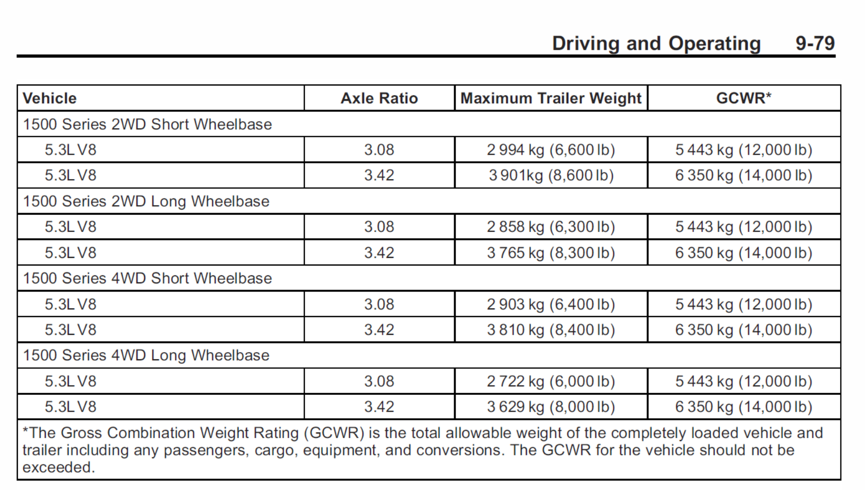

The bottom line is that no package is going to change your payload or rear axle rating. Those are the important numbers. Trailer tow rating is a meaningless/worthless number, especially with SUVs. Looking in the owners manual, the only difference in trailer rating is whether you have two or four wheel drive, and what axle ratio you have. There is no differentiation for any type of trim or tow package. A less-optioned vehicle is going to have a higher payload rating because things like heated/cooled seats and a sunroof add weight, which subtracts pound-for-pound from your max payload.
You're probably overloading the rear axle and payload anyways, so you might as well get what you want and not compromise just to get some alleged benefit from a towing package.
This is from the 2015 owners manual:
