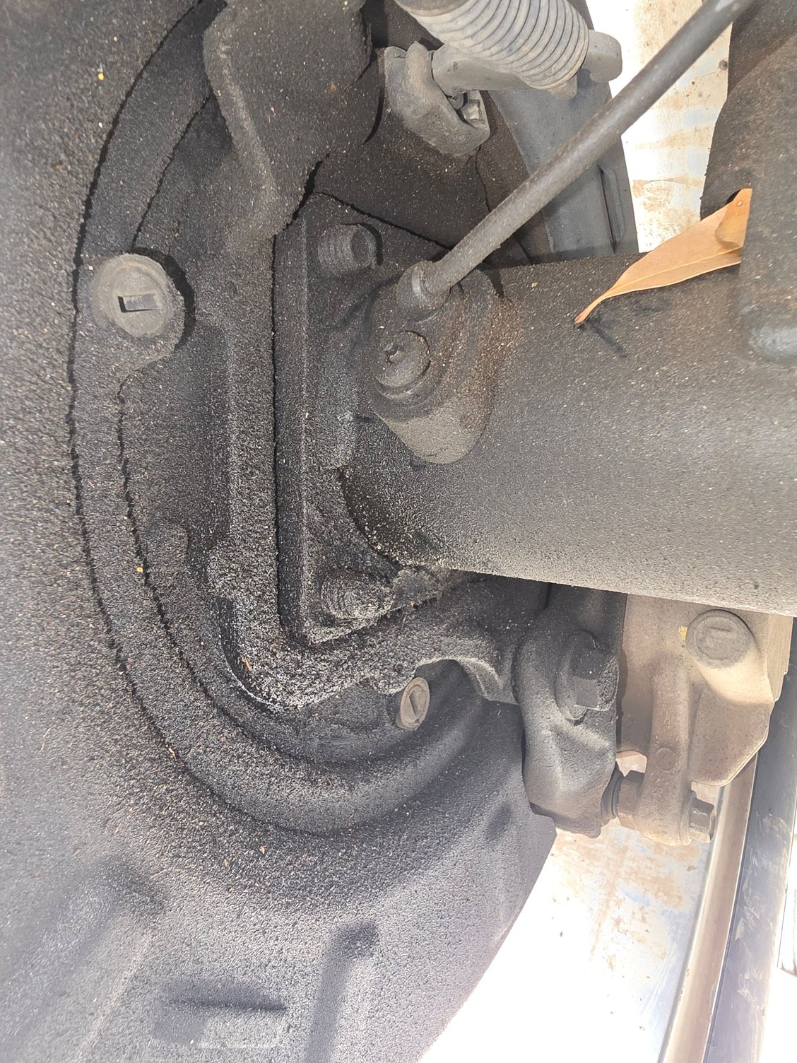

Well it appears my left rear wheel seal has failed and im assuming has leaked the bearing dry. It sounds like the noise is on the right side though. Guess I'll do both just in case. Got a quote and its $650 just for one side. Guess I'll be renting the bearing puller/installer tools and doing it myself lol.

Good find! After you replace the seals, make sure the differential gear oil is drained and replaced.

Well im going to have to replace the bearing anyways so everything comes apart anyways. I wish it were the front, or none at all! Anyways thank you for you response!
