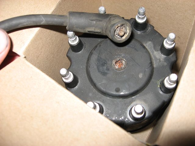

Well, problem got worse and decided that eventually I would find out what the issue was. Two days ago, it was raining and I could not get it to kick at all. I used starting ether to try to get it to kick and nothing. I got to thinking later that day that maybe I have an ignition issue. I had already changed the plugs a few weeks ago and it seemed to help performance wise, but not for the starts. The plugs were worn bad. I remember in the old days having trouble starting cars with cracked distributors when it was raining out. I had remembered having difficulty the last time it rained as well. I figured it was time for new wires, distributor cap, and coil anyway. When I pulled the plug from the coil, the plug on the distributor fell off. It wasn't even connected anymore and must have been arcing. Once I got everything changed out, the engine starts normal again, but I noticed a huge improvement in performance. Wow. Hasn't run this good since I got it!
