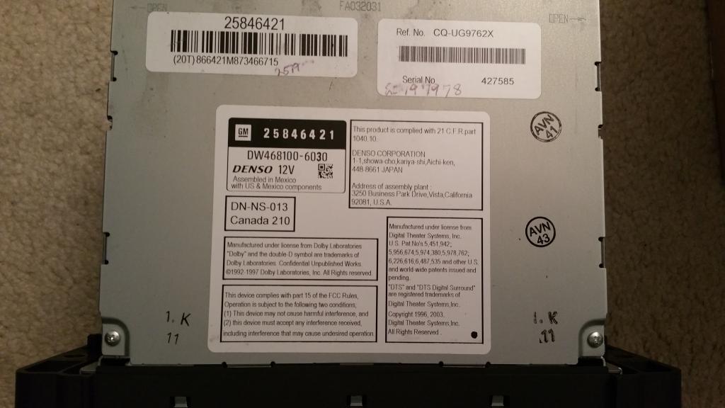

Aftermarket is probably your best bet, but if you want an OEM head unit, I have one, and I'd let it go for cheap. PM me if you're interested.
