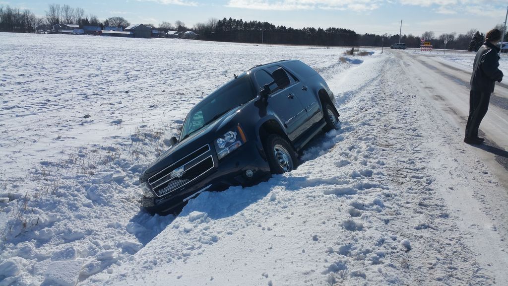

If you want the "ultimate" Suburban, look at the 2500 models. While they have the same body and look very similar to the 1500s, under that body is a completely different truck - different engine, transmission, frame, axles, brakes, bigger fuel tank, etc. My '08 2500 has 150k miles on it and it has been FLAWLESS. In the last three years I've paid exactly $20 in repairs - it's never been in a shop for anything besides regular maintenance/fluid changes. And I beat the snot out of it - towing heavy, fourwheeling, etc. In fact, my son did this just last weekend:
Only damage was a crack in the front bumper cover on the passenger side.
