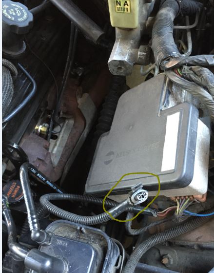

This is for a 1999 Chev Tahoe 4x4 5.7 with AC. Just replaced intake manifold gaskets, and head gaskets and have this left over stray 2-pin plug with pink/white wires. I cannot figure out where it is supposed to go....hopefully someone can take a peek at their setup or just happens to know. It's on the driver-side of the engine. Thanks

Searching the workshop manual one 2 lippi k white connector is for the evaporative emissions cannister purge solenoid valve. It's on top of a box like construction.
Thank You Very Much!
Any idea how things would work if disconnected vs. connected?

Sorry not sure. Would guess it would lead to overpressure in the tank but I'm guessing. Can anyone else help. Did you manage to find where the plug fits?
