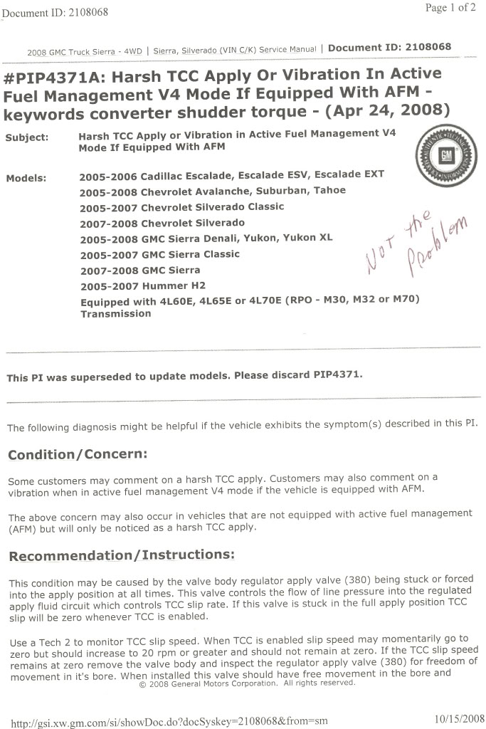

Apparently, others are experiencing the same issue.....

cam3439 : a small vibration and no humming noise, thank you i`ll do this and see what i would find out.<?xml:namespace prefix = o ns = "urn:schemas-microsoft-comfficeffice" /><o></o>
<o></o>
Harden : woow that is a good finding i`ll see about that this is the most reasonable explanation i have ever heard, i hope this is it, thanks 1000,000. <o></o>
Thank you all for your help
