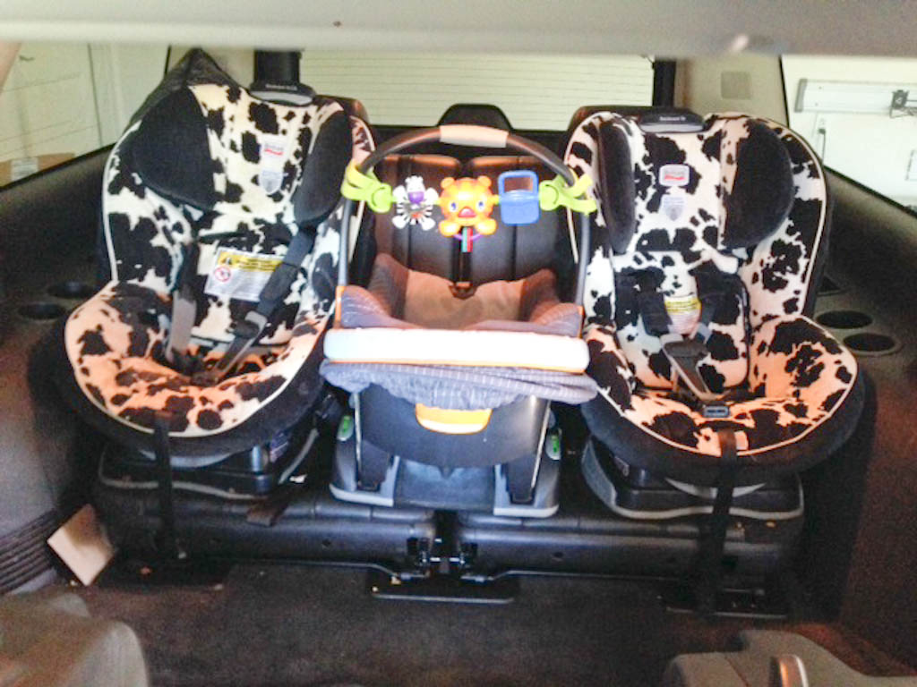

Went with an '08 LTZ 1500 last June with almost 135k miles, 5.3L with 3.73 gear ratio for for $17,500 and just under $19k OTD. We've only put about 3500 miles on it in the 3.5 months or so that we've had it but we've been very happy with it. We also use it as a third vehicle mostly to tow our boat/trailer (5700 lbs) so it's gotten some pretty high stress use and so far have not noticed any oil consumption issues with the AFM or any other issues. I will say though that the AFM issue was in the back of my mind when deciding whether to take our 'burb over our minivan for a recent 1000 mile road trip. We ended up taking our minivan though but I did play with the burb's carseat capability a bit. Not sure how old your other 2 kids are (congrats on #3, btw) but our 3 are all under 5. All three carseats fit in the third row with ease. Mind you that in many vehicles, a slimmer carseat is needed to fit 3 carseats in the same row but even with our two bulky front facing carseats and infant seat in between, there was plenty of installation room (attached pics).
Second row captains are a nice convenience and I personally don't miss the extra seating capacity. To us, it makes staying under payload ratings a little easier with one less passenger seat.
