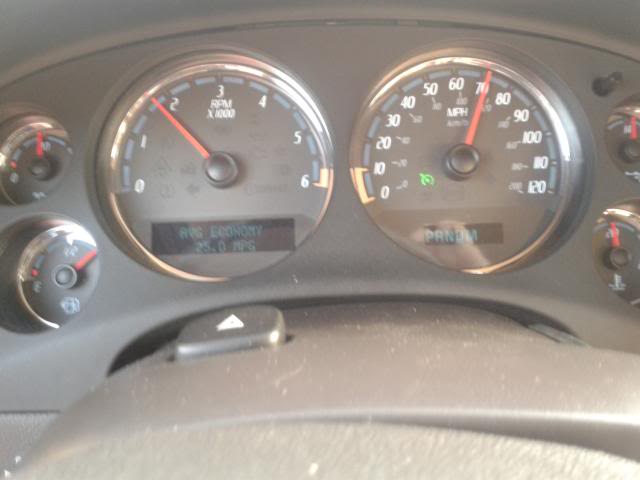

Yep, we see ring alignment on the 07 engine all the time, thankfully GM caught it pretty quick and it only seems to effect the 07's and mostly just 5.3.
As for Tahoe (AKA Dirty hoe) economy with a LMM, yes we see 26-28, my wifes 07 Denali XL pulls 25 at 72 mph faithfully with all 3 of our teens and gear
and you can blow the rear wheels off through 1st and 2nd gar!
Gotta love that
