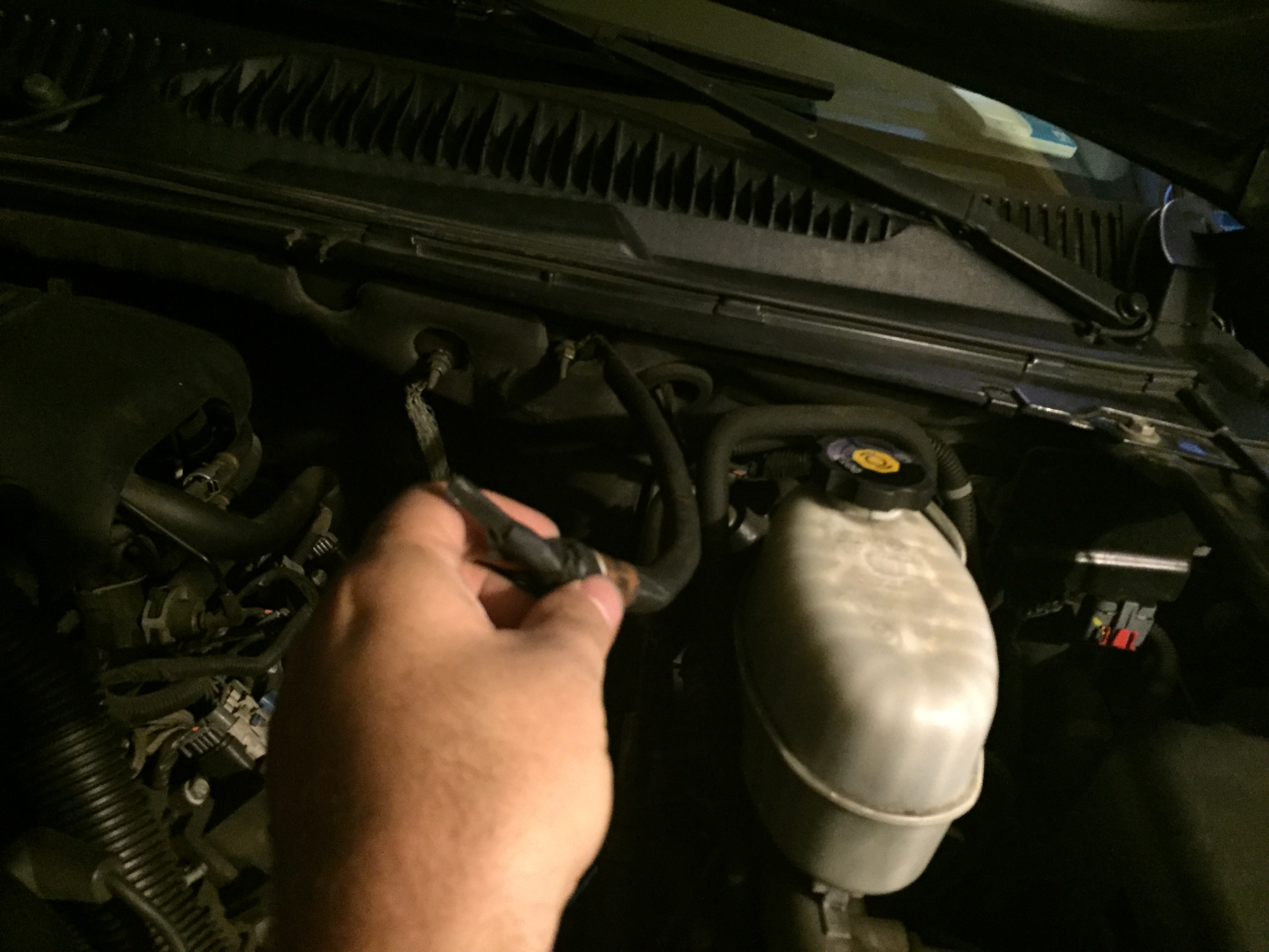

This looks like a ground from the firewall, curious where it goes? Looks like it broke at one end and someone taped it up. I haven't untaped it to see if it is a ground, I figured I would ask here first.

That looks to be engine ground strap (G107). One end screws to the firewall and the other end bolts to the back of the driver side cylinder head.
Old Aug 31, 2016 | 10:51 PM
on my truck, one firewall strap goes to a stud on the hood

Tech2 Thank you. This is what it is. I was able to verify with the part number in it. Thank you.
