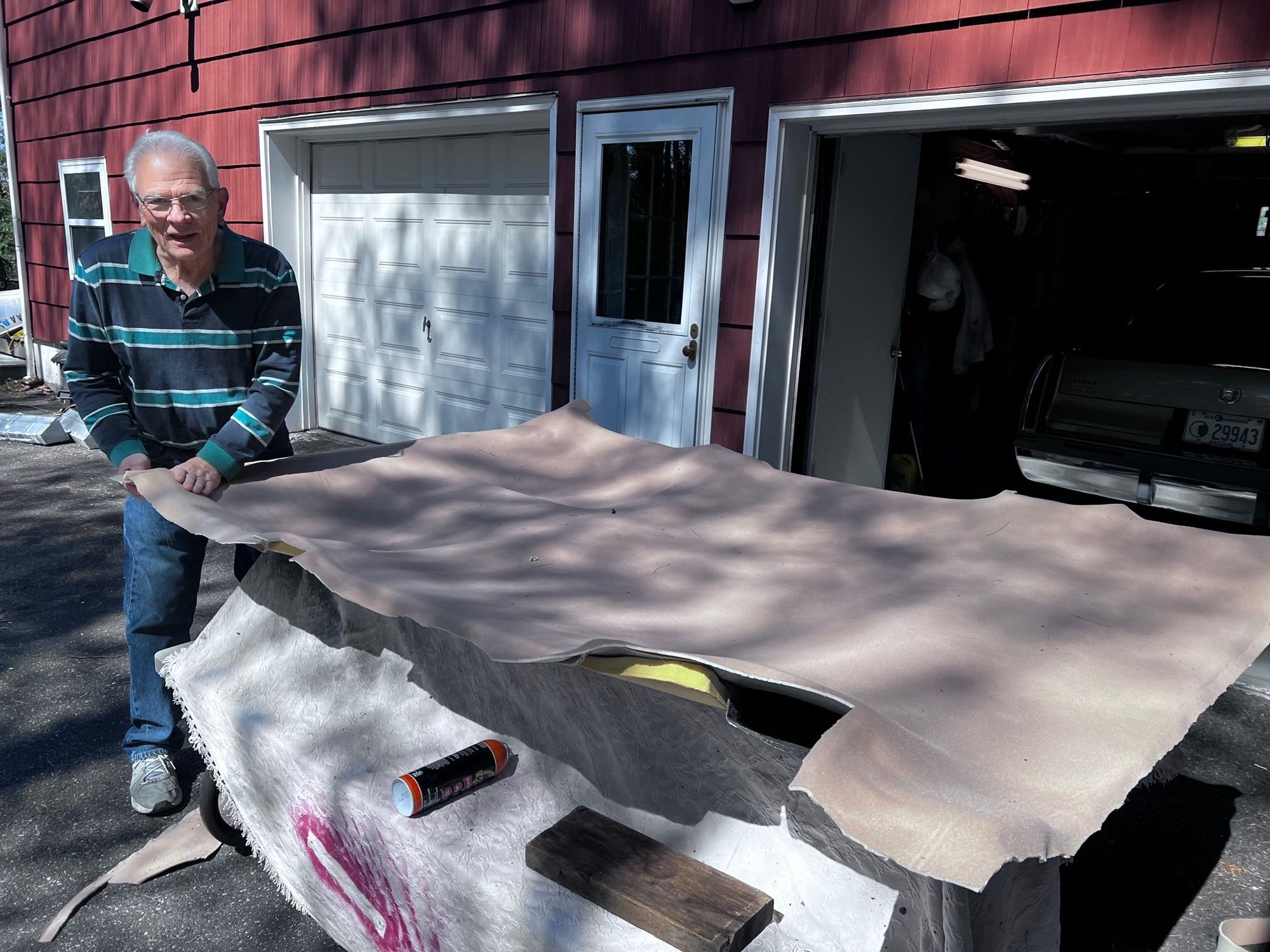

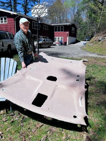

3.Time for the old stuff to come off. The cloth will peel right off. Now the fun begins. The foam backing is glued onto the fiberglass headliner board. That's got to come off. In doing some research, guys said to use a scrub brush or a coarse brush. Didn't take me long to realize that I would still be there removing foam if I didn't think of another way. So I tried a wire welding brush, piece of cake. I was done in a 1/2 hour.
Headliner with foam removed. Where fiberglass had a week spot, I reinforced with fiberglass
I bought the headliner material at JoAnn's Fabrics. Material and 4 cans of spray adhesive at HD = $115 total
Measure and cut the material, leaving about 2" extra all around.
Spray adhesive on both sides and let get tacky. Only spray 1/2 at a time (both sides). It makes it easy to work with. Smooth it out with you hands. I also used a 3" paint roller, it helped a lot.
All done, waiting for the Mrs. to install.

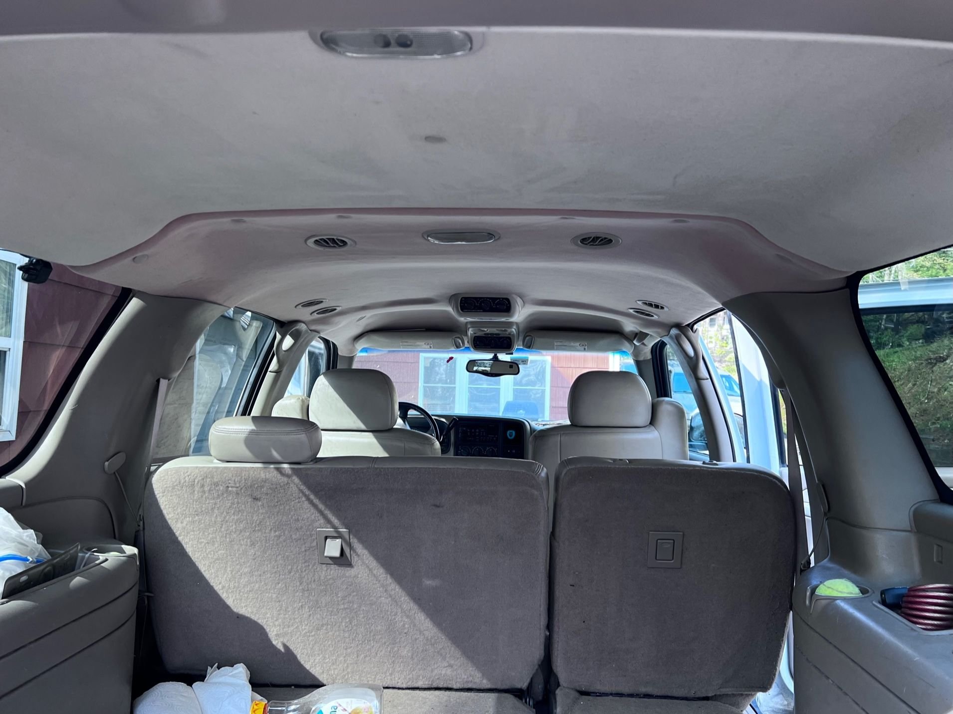

All done and installed, really not that bad of a job.
First time ever attempting this. I am real happy with how it looks. The Yukon headliner is in two pieces. I believe a 7 ft. and a 3 ft. piece. I only did the 7 ft piece, as it had seen better days. The 3 ft piece was in excellent shape, I will save that one for a slow day.
