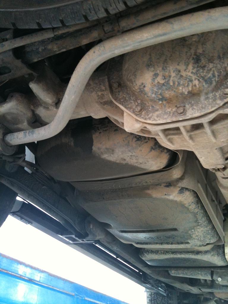

So I went to the service shop but could not locate the vent valve
I found the solenoid canister but the vent valve seems to be well hidden.
I took a picture, maybe you could please show me where to look for it.

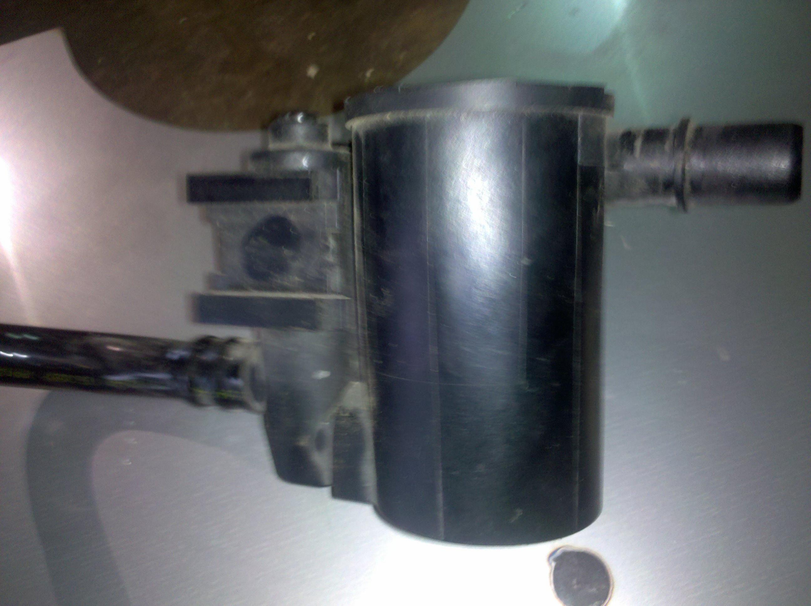

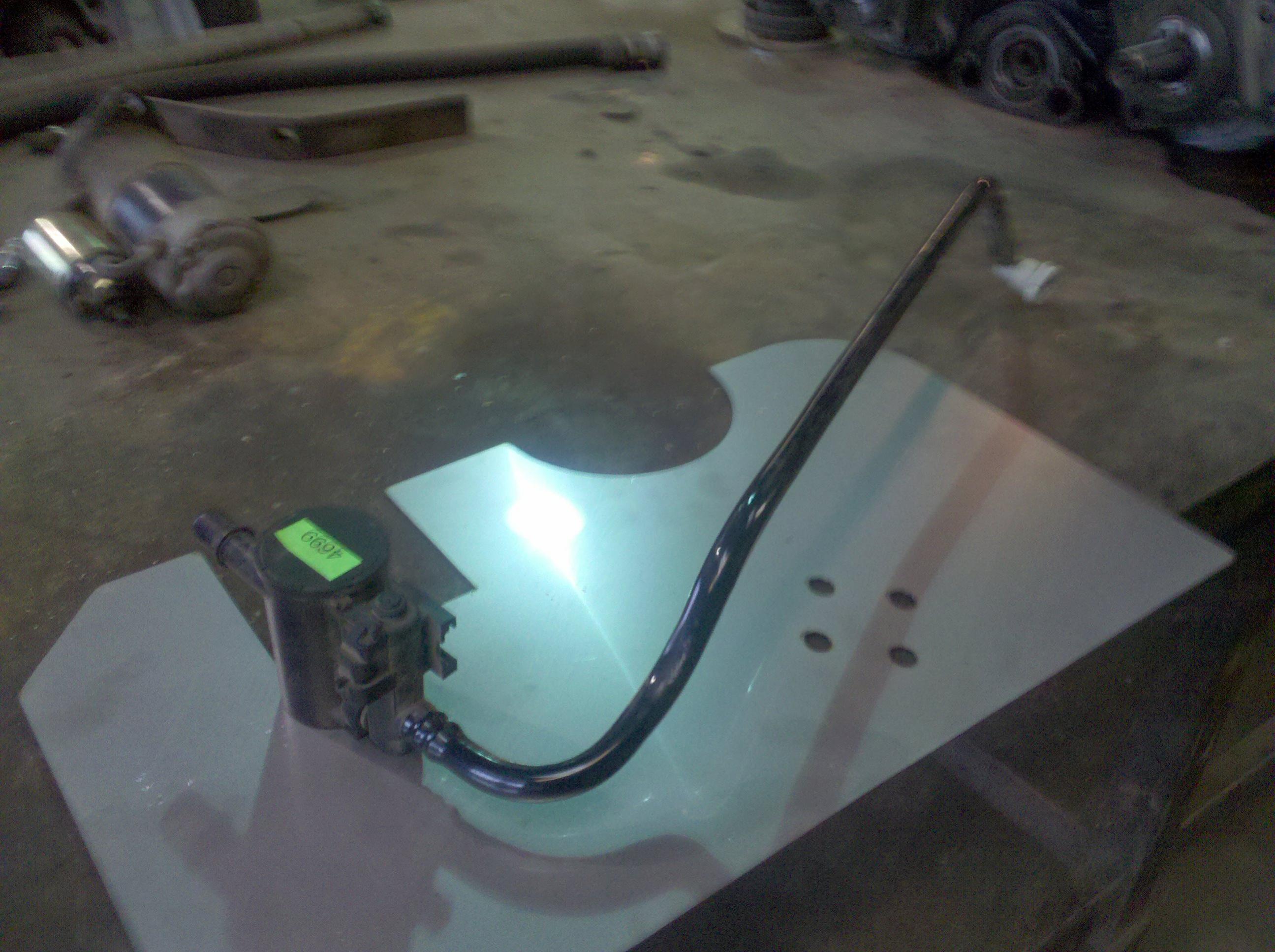

Default ill send ya a pic
im not 100 % sure on your tahoe but on my 2000 suburban it is just to the rear of the gas tank. I just happen to have the exact valve at my shop ill take a pic of it and post it here tommorow evening. A friend bought a 2008 tahoe that was wrecked and parted it out. So i grabed a few things that i thought i might need. but i can tell ya IT IS NOT in the tank

Default vent solinoid pics
There ya go hope it helps
