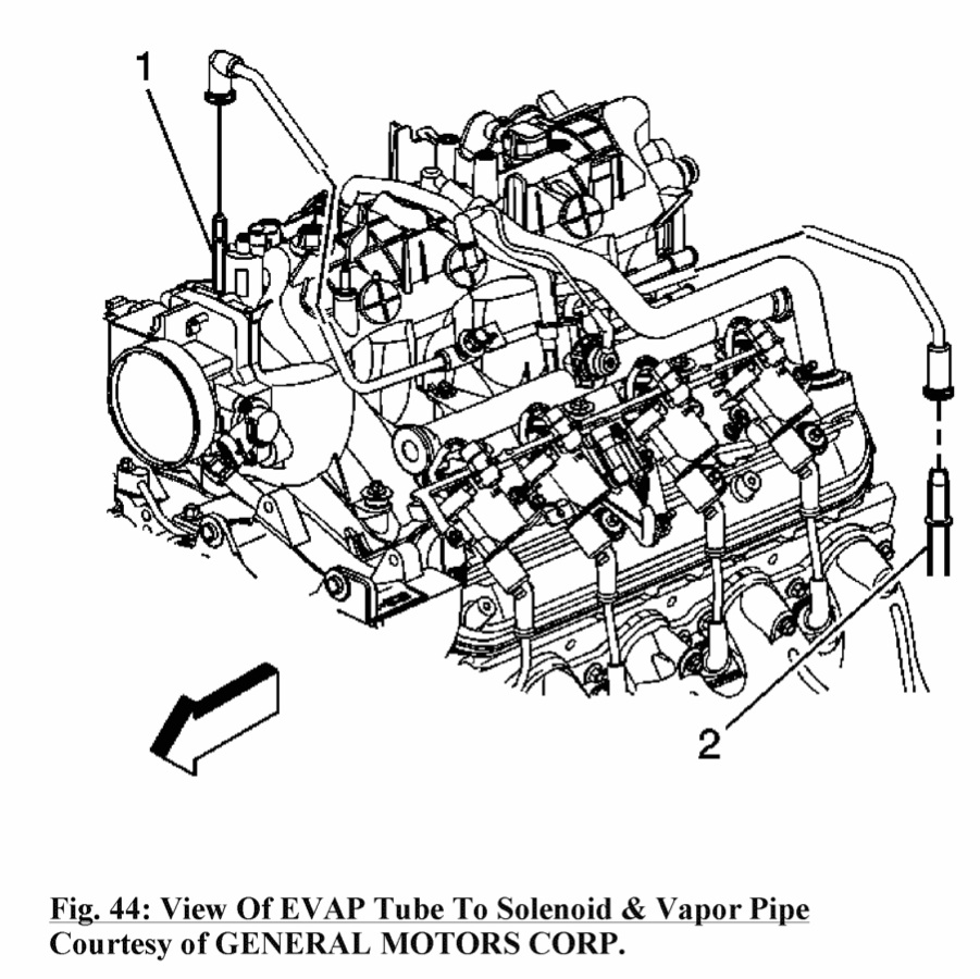

Well, when you replace the gaskets from the intake manifold, if they haven't properly installed can be one of the reasons of the oil leak. Se the picture down here. Another reason for the oil leak, that I have forgot to mention could be from the vapor pipe (second picture).
Let me know if you have any doubts to help you.
