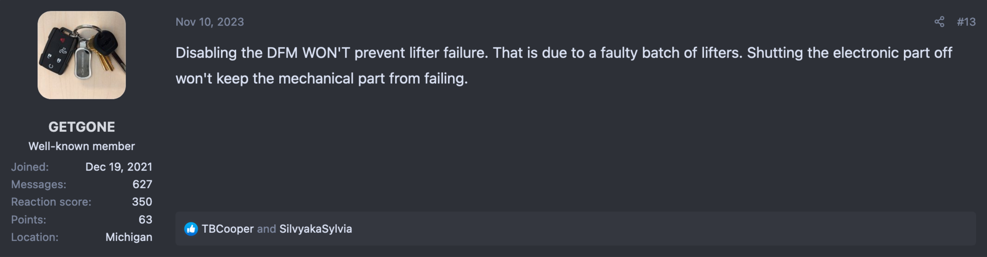

Not odd at all. It's a mechanical problem. Range does disable 4cyl mode, but that just hides the problem. It's more of a "pedal feels good" thing for people.
It's a terribly designed engine. No software is going to magically keep it from spraying oil all over the cylinder walls, for example.
software can't make up for faulty oil pickup o-rings, or failed VLOMs. It's an oil pressure issue, not a software issue.
