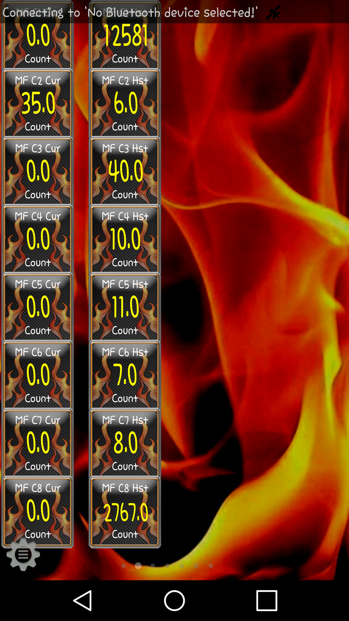

Can you post the number of misfire counts on each cylinder?
Freeze frame data for P0301?

Misfires on cylinder one high enough to set P0301.
The other cylinder misfires except cylinder eight are low and probably normal.
Since firing order is 1-8, they may be influencing each other or 8 could have actual misfire.
May try swapping 8-6 to see if makes a difference.
Note: reset code and cylinder current/ history counts to get a fresh look.
The P0301 isn't a hard misfire correct? Check engine light doesn't flash?
Since freeze frame shows misfire at light load and cylinder 1 having counts high enough to set P0301 could be injector is over fueling at light loads
Don't know if you can swap injectors.
